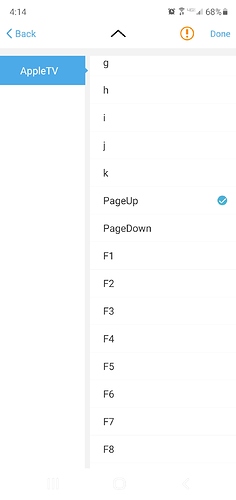

My Sofabaton up/down buttons, mapped to pageup/pagedown per the directions, don't work for live tv channels or in the guide anymore.
Just tried mine again both channel up/down and guide page up/down work fine. The only thing on the guide is it pages down one channel to far so I miss one channel on each page. I'm running beta 11.3.112
Are they mapped to PageUp/down or ChannelUp/Down?
That's how mine is setup and it no longer does anything in the guide or watching live. On server 2020.11.07.0256, and running the AppleTV beta Channels now, just updated to see if it fixed it.
