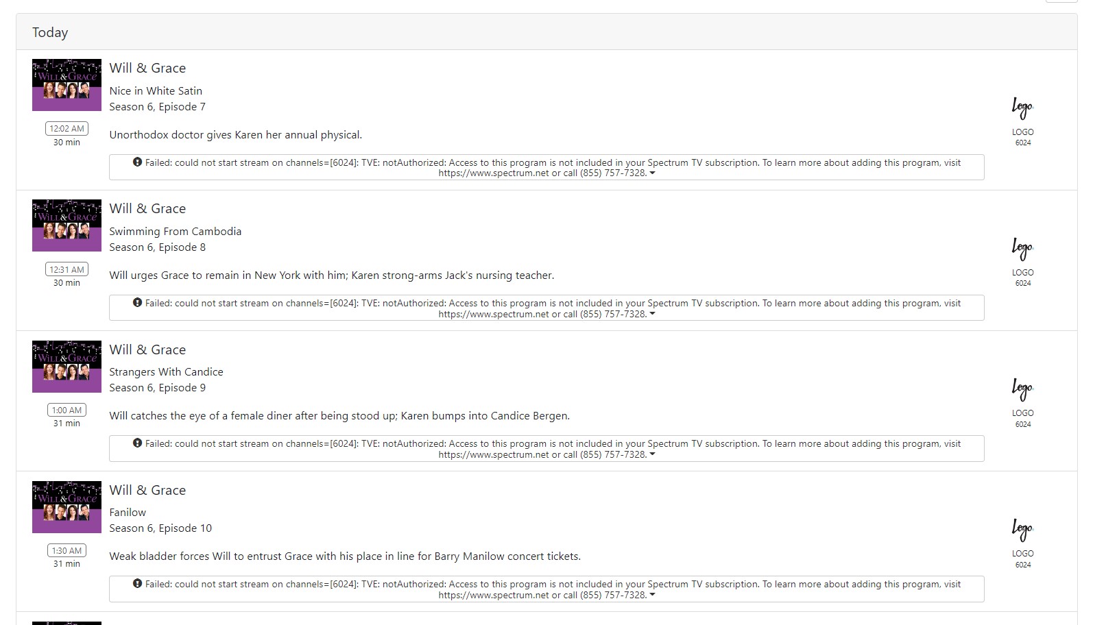

If I go to the schedule on my TV, it will show the skipped programs with a red exclamation mark. If I click an individual skipped program, it will show an error message, "Could not start stream on channels=(6024): TVE not A(cuts off rest of word) program is not included in your Spectrum TV subscription." Then tells me how to add that channel.
It is Logo and channel number 6024 is assigned that channel on both Directv and Spectrum. Logo shows up on the Spectrum list even though it says it is not part of my package. I have disabled it in the channels list, but didn't fix the problem.

You can click the gear icon next to Spectrum, select Rescan, then find those channels and click Rescan next to them. It should remove the checkmark and then it won't try to use Spectrum for that channel in the future.
After disabling the channel I've found you need to reload the guide data.
Guide Database > Maintenance :gear: Delete and Recreate Database
Guide refresh doesn't matter for multiple TVE sources.
Please try what I told you earlier to rescan that channel and ensure it doesn't have a checkbox on the right under Rescan
