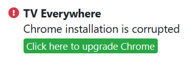

I'm getting the following error:
TVE: chrome failed to start:
/system.slice/channels-dvr.service is not a snap cgroup
You need to install or upgrade chrome on your Ubuntu

I'm having this same problem encountered when setting up my SECOND TVE connection. The first connected and added channels without issue. This suggest that chromium-browser has been setup.
Try to uninstall the snap version of chrome/chromium on Ubuntu, that was the cause for me.
Install the regular version of chrome from a PPA: How To Install Google Chrome on Ubuntu 20.04 – TecAdmin
