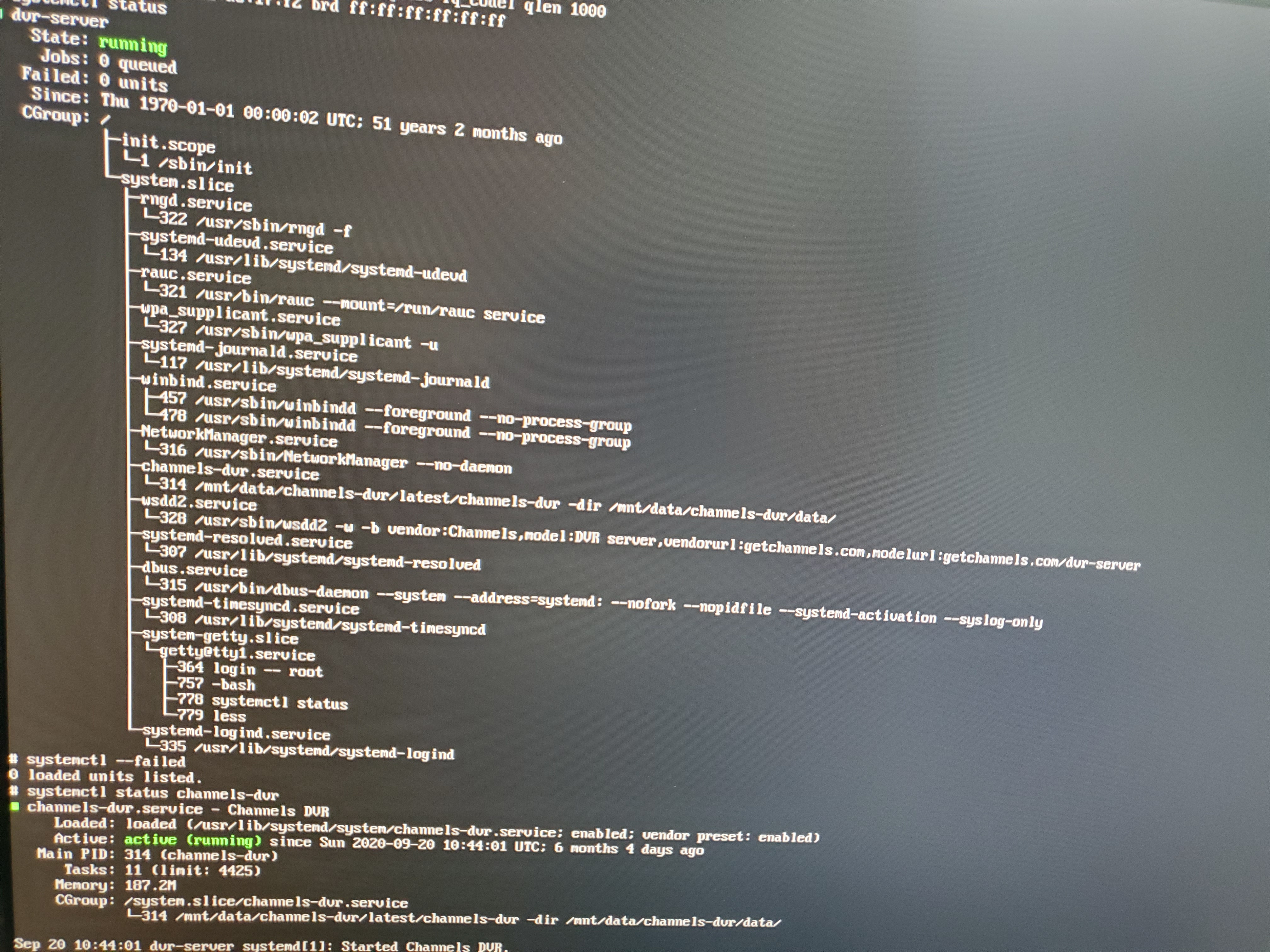

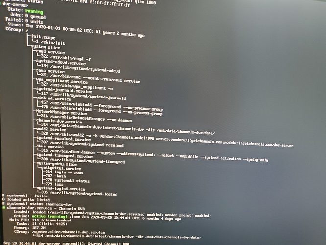

On the Pi, what do these commands output:
systemctl status
systemctl --failed
systemctl status channels-dvr
Please take a photo if that's easier
OK took a minute to get phone connected
