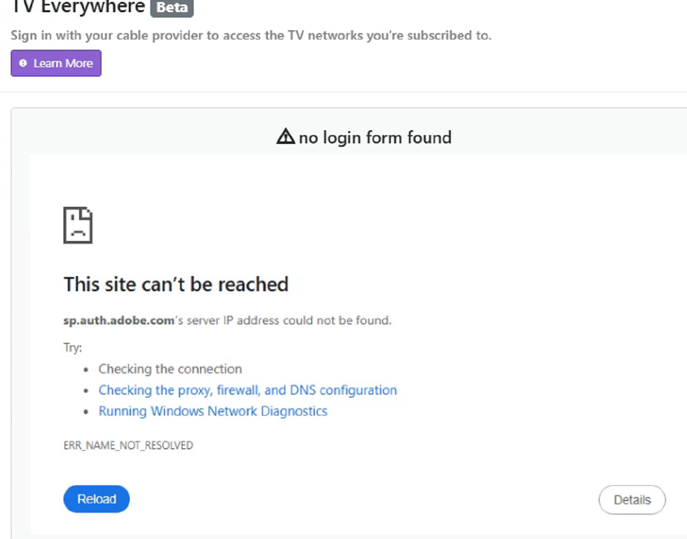

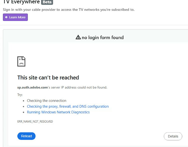

I did remove and re-add the source and got this error:

That looks like a dns error. Do you have any ad-blockers running or ad blocking dns such as pi-hole or adguard home?
No adblockers. They seem more trouble than they are worth.
I do run Quad-9 for DNS.
For giggles, I changed the DNS over to OpenDNS for that machine and was able to re-add the Source and this time FS1 was picked up.
Odd, since I was able to sign-in to Fox sports website with the same DNS settings.
Thanks for the reminder to check DNS.
