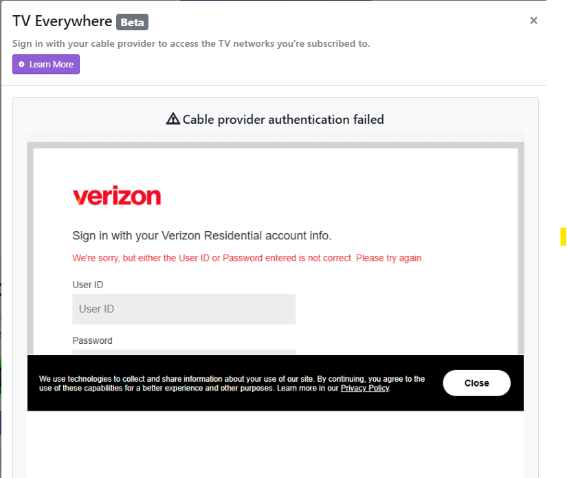

I have tried: installing the prerelease, changing fios password, logging into fios first, etc. Every time:
I hate to say this, but this is a Verizon issue. It took me a week of trying, like three times a day, and it finally worked.
Sure looks like it's not clicking on the banner Close button before entering your credentials.

yes, i submitted all the logs. As for the banner in the screenshot, none of the fields in there are active. you can't type anything, can't click anything

Can you post the connection attempt log from CDVR here? And the URL where you log in successfully?
just updated to 2026.08.25.1652
https://tv.verizon.com/watch/home/
Logs from today: (username and other PII redacted)

2026/08/25 13:18:07.329954 [TVE] Auth starting for Verizon as {username}
2026/08/25 13:18:11.877612 [TVE] action=auth mvpd=Verizon requestor=discovery
2026/08/25 13:18:13.723003 [TVE] action=version product=Chrome/151.0.7922.174 jsVersion=15.1.206.23 protocol=1.3 revision=@39c51c70dd5feca6b6aba5bb7997b595011c553d
2026/08/25 13:18:13.735912 [TVE] action=page_ready chromeVersion=151
2026/08/25 13:18:13.742298 [TVE] action=navigate url=https://sp.auth.adobe.com/adobe-services/authenticate/saml?domain_name=adobe.com&mso_id=Verizon&no_iframe=true&noflash=true&redirect_url=https%3A%2F%2Fsp.auth.adobe.com%2Fadobe-services%2FcompletePassiveAuthentication&reg_code=&requestor_id=discovery
2026/08/25 13:18:13.776291 [TVE] action=request type=Document method=GET url=https://sp.auth.adobe.com/adobe-services/authenticate/saml
2026/08/25 13:18:13.844468 [TVE] action=request type=Document method=GET url=https://ssoauth.verizon.com/sso/VOLPortalLogin redirected_from=https://sp.auth.adobe.com/adobe-services/authenticate/saml
2026/08/25 13:18:13.844468 [TVE] action=auth_domain domain=ssoauth.verizon.com
2026/08/25 13:18:14.020284 [TVE] action=wait_for_page
2026/08/25 13:18:20.430404 [TVE] action=page_ready
2026/08/25 13:18:20.430404 [TVE] action=wait_for_page done=true reason=page_ready
2026/08/25 13:18:20.430404 [TVE] action=wait_for_auth timeout=12s
2026/08/25 13:18:20.430404 [TVE] action=fill_form u={username}
2026/08/25 13:18:20.487673 [TVE] action=request type=Document method=POST url=https://ssoauth.verizon.com/sso/TVPFR7HandlerServlet
2026/08/25 13:18:26.305600 [TVE] action=page_ready
2026/08/25 13:18:26.305600 [TVE] action=check_result
2026/08/25 13:18:26.352090 [TVE] action=akamai_challenge state=detected target=checkbox x=379.27518868277605 y=166.95700965974618
2026/08/25 13:18:26.352090 [TVE] action=akamai_challenge state=click num=1 target=checkbox x=379.27518868277605 y=166.95700965974618
2026/08/25 13:18:30.362006 [TVE] action=check_result
2026/08/25 13:18:30.373515 [TVE] action=akamai_challenge state=detected target=proceed x=374.10025899464216 y=249.24916621773582
2026/08/25 13:18:30.474142 [TVE] action=akamai_challenge state=click num=2 target=proceed x=374.10025899464216 y=249.24916621773582
2026/08/25 13:18:32.855712 [TVE] action=request type=Document method=POST url=https://ssoauth.verizon.com/sso/TVPFR7HandlerServlet
2026/08/25 13:18:33.414860 [TVE] action=request type=Document method=GET url=https://ssoauth.verizon.com/sso/VOLPortalLogin redirected_from=https://ssoauth.verizon.com/sso/TVPFR7HandlerServlet
2026/08/25 13:18:34.756962 [TVE] action=check_result
2026/08/25 13:18:34.867457 [TVE] action=akamai_challenge state=cleared
2026/08/25 13:18:39.089232 [TVE] action=page_ready
2026/08/25 13:18:39.089232 [TVE] action=check_result
2026/08/25 13:18:39.104266 [TVE] action=akamai_challenge state=refill_form count=1
2026/08/25 13:18:39.104266 [TVE] action=wait_for_auth timeout=12s
2026/08/25 13:18:39.104902 [TVE] action=fill_form u={username}
2026/08/25 13:18:39.159624 [TVE] action=request type=Document method=POST url=https://ssoauth.verizon.com/sso/TVPFR7HandlerServlet
2026/08/25 13:18:39.495464 [TVE] action=request type=Document method=GET url=https://ssoauth.verizon.com/sso/VOLPortalLogin redirected_from=https://ssoauth.verizon.com/sso/TVPFR7HandlerServlet
2026/08/25 13:18:45.359086 [TVE] action=page_ready
2026/08/25 13:18:45.359086 [TVE] action=check_result
2026/08/25 13:18:51.105695 [TVE] action=check_result
2026/08/25 13:18:51.217657 [TVE] action=auth_timed_out akamai=false
2026/08/25 13:18:51.217657 [TVE] action=screenshot
2026/08/25 13:18:51.336859 [TVE] action=screenshot file=tve_error_screenshot.png size=22148
2026/08/25 13:18:51.339207 [TVE] action=capture_html
2026/08/25 13:18:51.437019 [TVE] action=capture_html file=tve_error_screenshot.html size=307195
2026/08/25 13:18:51.441003 [TVE] action=capture_html
2026/08/25 13:18:51.532341 [TVE] action=capture_html file=tve_error_screenshot.html size=307195
2026/08/25 13:18:53.861577 [TVE] Auth failed for Verizon: Cable provider authentication failed
