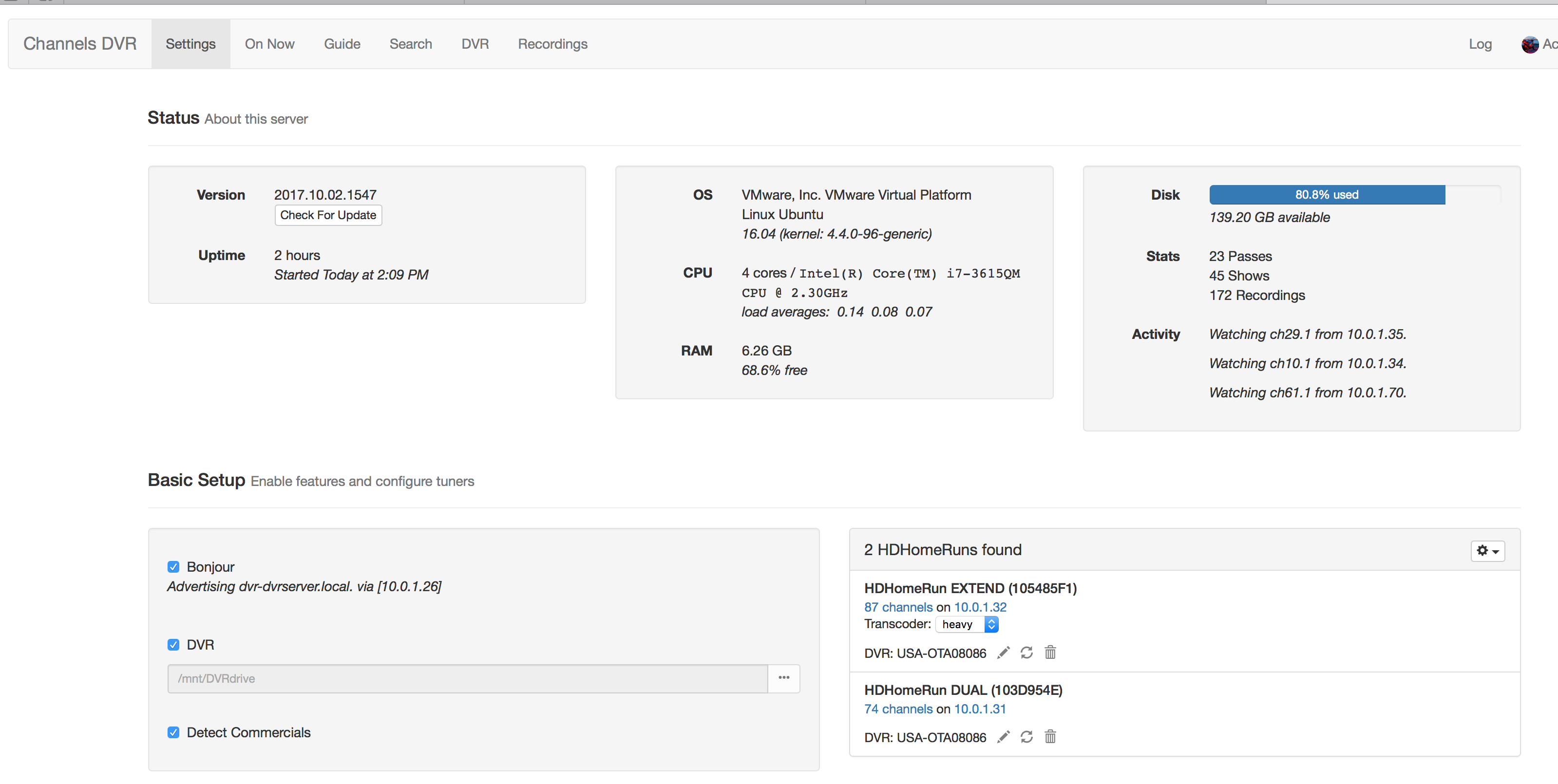

I can run 3 streams at once… 2 of them SHOULD be on the DUAL, but instead it looks like 2 of them are on the EXTEND. One of them is on the DUAL – but I cannot get the 4th stream to work; I get the “Tuner Not Available” when trying to utilize the 2nd tuner (last one available) on the Dual…
So… better! ¾ of the way to working I’d say!

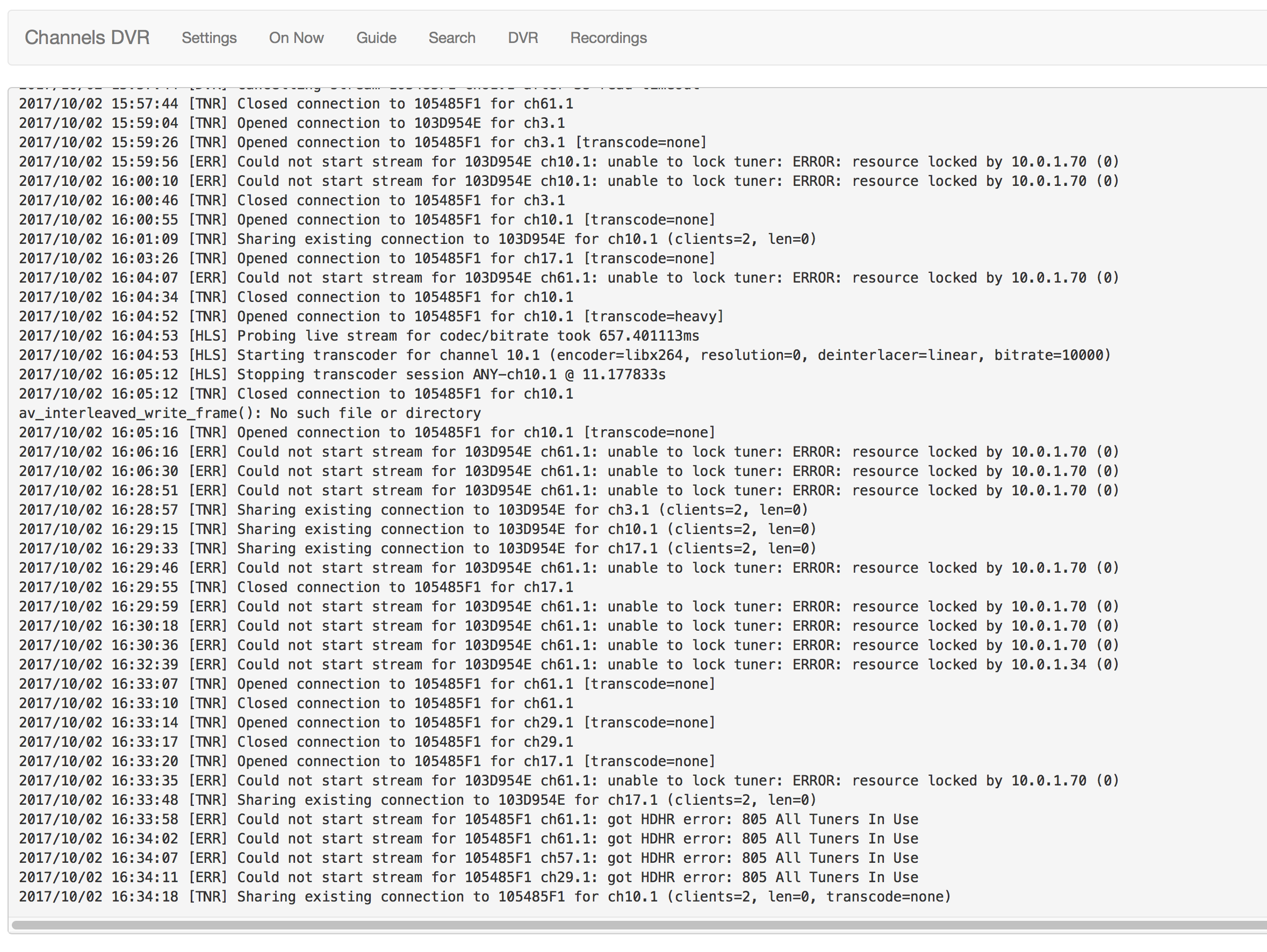

Does the Log show any errors when you try to tune in to the fourth channel?
Yes, see screenshot...
Even when the situation above (all tuners in use) is listed in the logs, I still only have 1 LED our of the 2 illuminated on the HDHR Dual. Both channels are in use on the EXTEND
