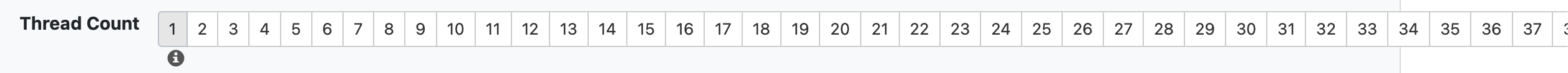

P.S. It may be better to make this a simple number indicator with +/– buttons once the number of cores is over 30 or something... :wink:
