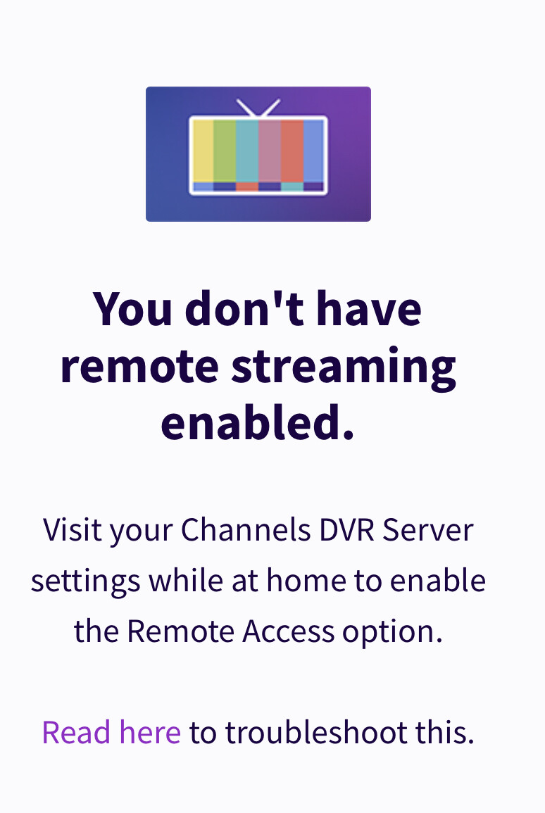

I’m trying to watch remotely on my iPhone but getting the error below. Do I need to use Tailscale on my phone? If that’s the case, what about my AppleTV and Google TV if remote?
Yes you need to install Tailscale on the clients.
On Apple TV beta there's an option in the app to setup Tailscale directly since they don't have a client app for tvOS
Thanks everyone. I think I’ll go back to just doing a port forward. Tailscale looks very interesting but I think I prefer the flexibility to use other devices without having to set up Tailscale for each one just to watch Channels.
