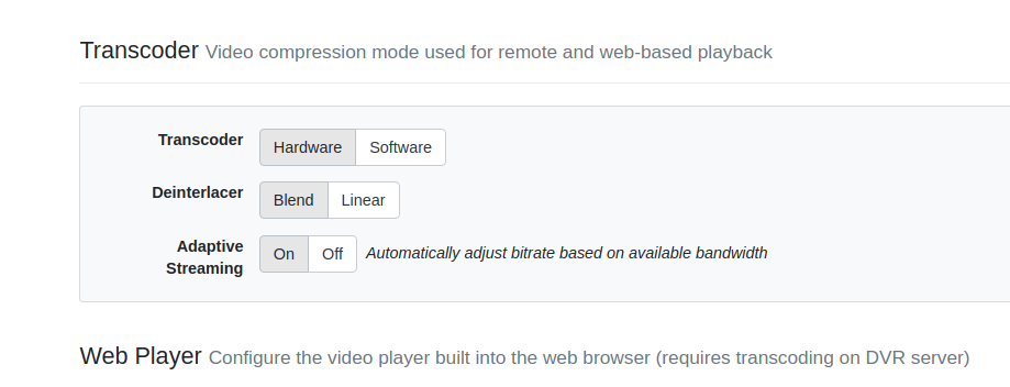

I recently migrated my DVR to unraid from a windows desktop and installed the nvidia docker. I think my gpu is used for transcoding, but not sure since it's not an option in the DVR GUI. I can see a light load on the gpu when viewing a show via browser. In the windows version I had the option to select hardware for transcoding.

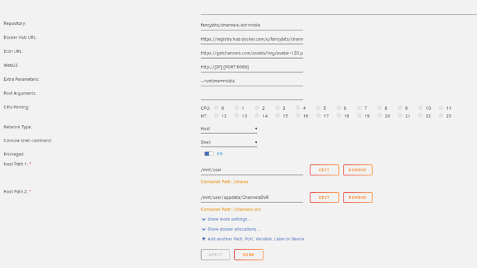

Am I missing a setting? I was under the impression no additional changes were necessary when installing the docker. Included a screen shot for reference.
Pretty sure if you aren't seeing the option it's doing it in software only. I'm on a test linux box and only saw hardware when I updated the nvidia drivers from the open source ones. My CPU doesn't have the necessary capability to include hardware so I know it's my GPU that's enabling the hardware option.

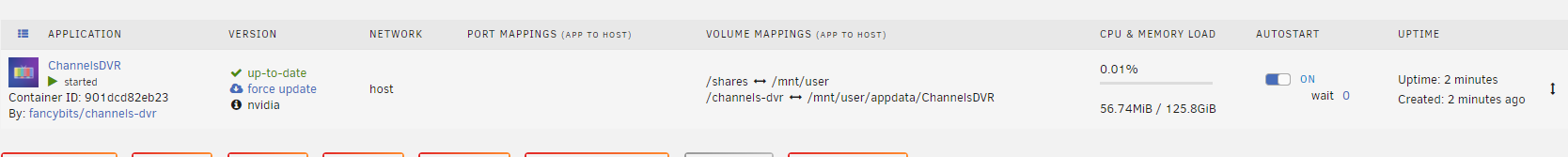

I've included some pics from my setup, the one thing different I see from my initial post is on the docker tab, I see nvidia listed in the version data.

Also looking at your 'Host Path 1' I wouldn't recommend putting all of your shares there. I would limit it to specifically the media folder for channels, i.e. /mnt/user/data/Media/ChannelsDVR or however you have that setup.

I also tried a couple of installs (1 restore, 1 fresh install) and HW encoding refuses to be an option. Also, showing more settings is empty and doesn't give me the nvidia visible devices to assign my GUP ID (advanced view). I can confirm I can assign my GPU to Plex for transcoding as similarly defined above so the GPU is available (confirmed via GPU stats that Plex is an active service).

Not sure what to do now. After the last restore install, Nvidia is not showing up in the docker tab like previously show in the image.
Are you using the Fancybits Channels template or did you just fill everything in? I looked at the template @tmm1 made and those variables are there.
