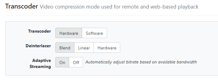

When using transcoding to an iOS device (at home or away) the video buffers every few seconds and is unwatchable. I can watch in original format on the same device with no issues. DVR is running on a DS218+. Any advice?
Is the server web UI set to hardware transcoding mode?
Yes it is. See below.
Is there a reason why your deinterlacer is not set to Hardware?
Not that I know of, but I didn't catch that. I'll change it to see if that helps.
That was it. Thanks so much!
