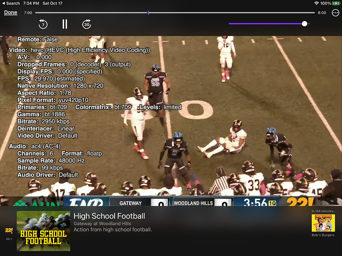

I think if you have the lastest Channels tvOS or iOS client you can enable Stats for Nerds to see what's coming into the client.

Yes. The DVR is transcoding the channel to get it down to 1080. Setting the client to original I loose sound. I'm using the Android TV App on the Shield. Using an iPad it's the same; no audio with original.
So that says there is audio being transmitted if the Channels DVR server is able to transcode the video and audio. You should be able to see what the transcoder is doing by looking at the DVR log.
Most likely there are very few client devices that handle AC-4 audio. I've heard some new LG TV's do, not sure what else.
