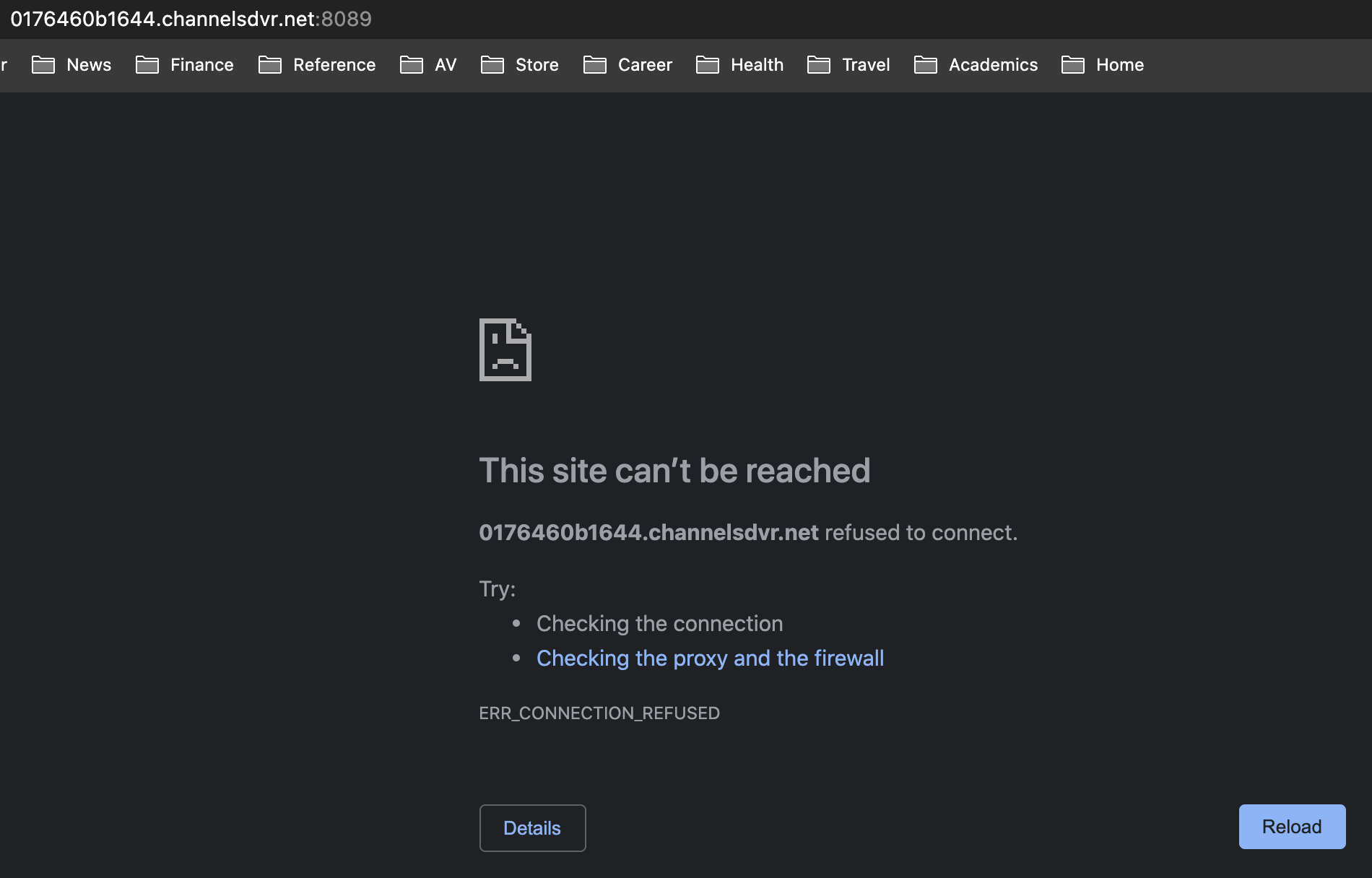

Indeed there is: https://my.channelsdvr.net
I tried that before, but didn't work...

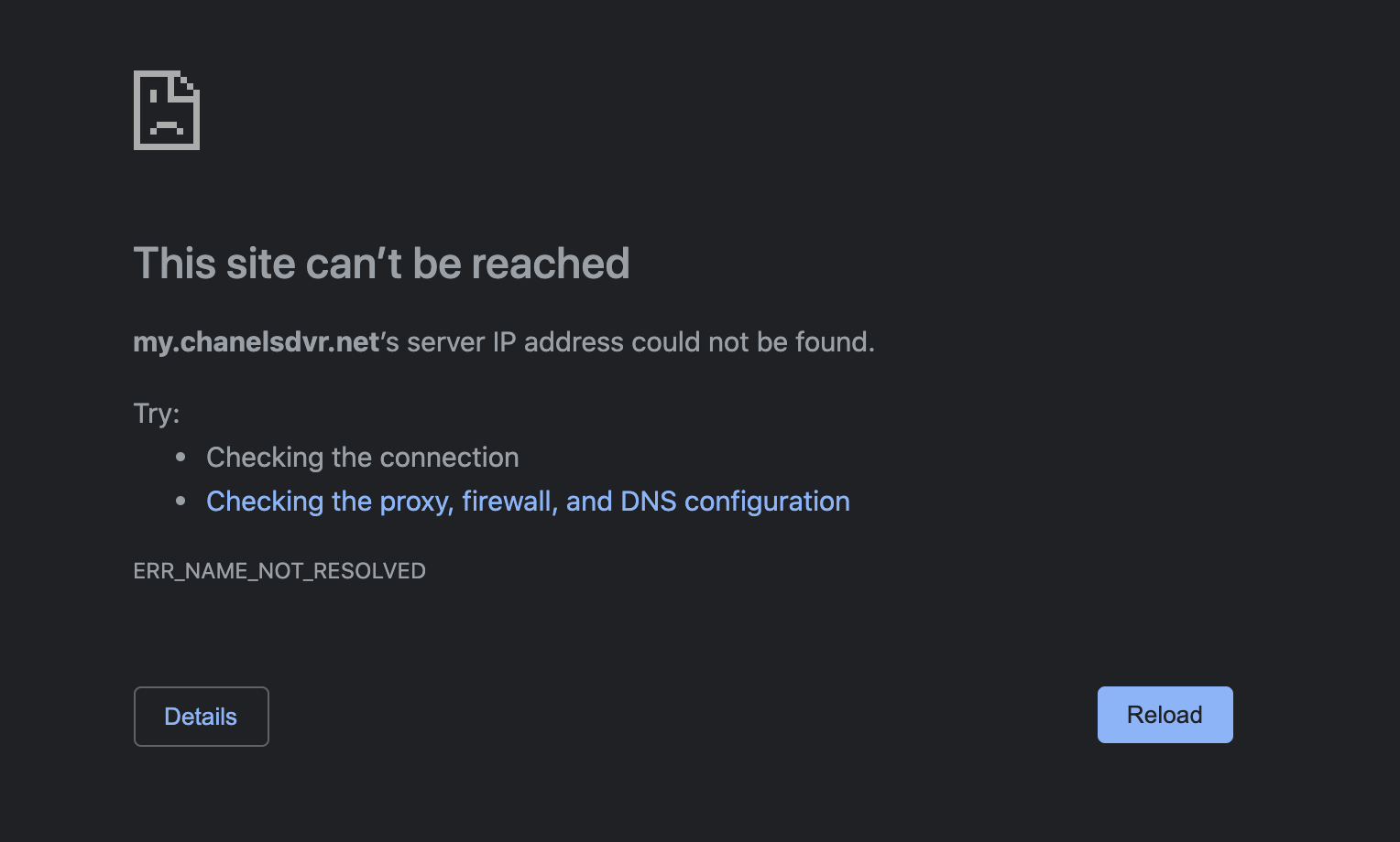

I think you have a typo there. Should be http://my.channelsdvr.net. Works for me.
Just tried it. Same thing...
My guess is that unless I have it set to allow remote access, the above URLs won't work. I don't want to go through the hassles of setting up forwarding a port. Anyway, there should be just a URL I can use at home on my laptop (which is different from where the server is).
You have to setup port forwarding on your router.
Not exactly what I am asking. I am at Home (on the same network as my server) and have my laptop which is not the server. Is there no universal URL that allows me to access it?
I don't want to set up port forwarding since it is a hassle with my Cox router.
There is no way to do what you're asking. The DVR is accessible using the name of your computer on port 8089.
