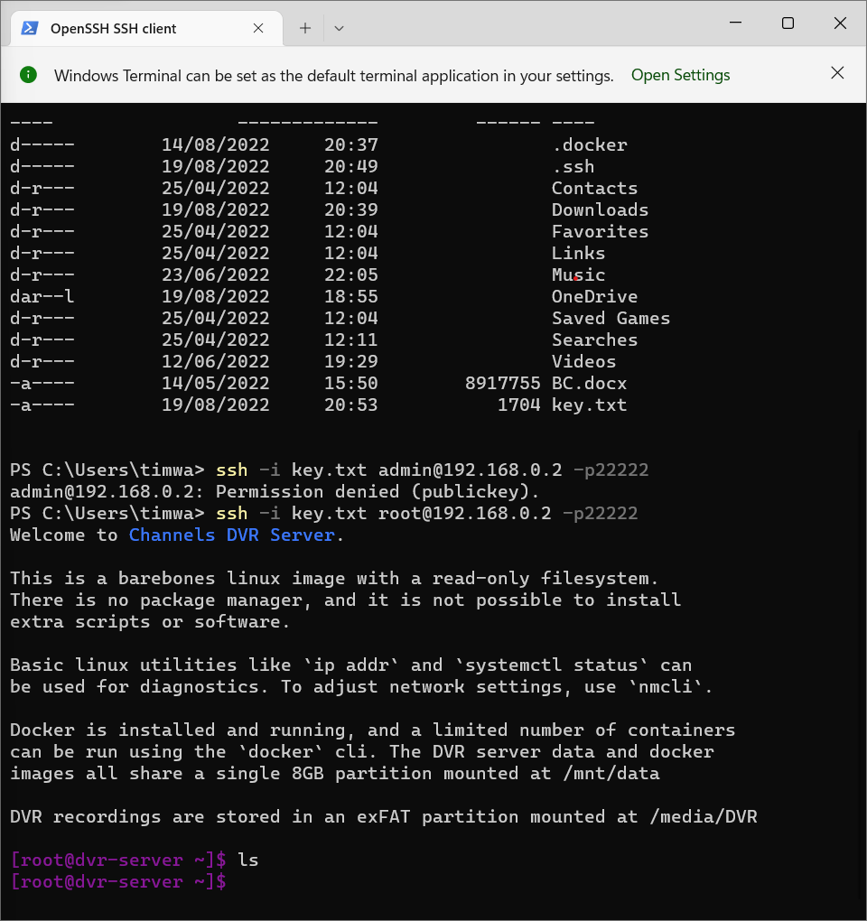

I want to be able to dial in to docker on the Pi from my Windows PC and install other applications.
Is this possible, and can you help with a step-by-step guide please.
I've been trying to access Docker for a while with no luck, I understand I need an SSH key, which I have, but I'm not getting anywhere, I've tried to replicate what I did to install Pluto, but I think since I have it already, the process doesn't work, or I'm doing something wrong.
An absolute idiot's step by step guide, or a link to an idiot's guide would be greatly appreciated.
Thank you
Note: I have managed to log in to the Pi with SSH using Windows Terminal.
I'm slowly working things out and I'm going to try and see if I can do anything with docker from here.
Any help is still apreciated.
