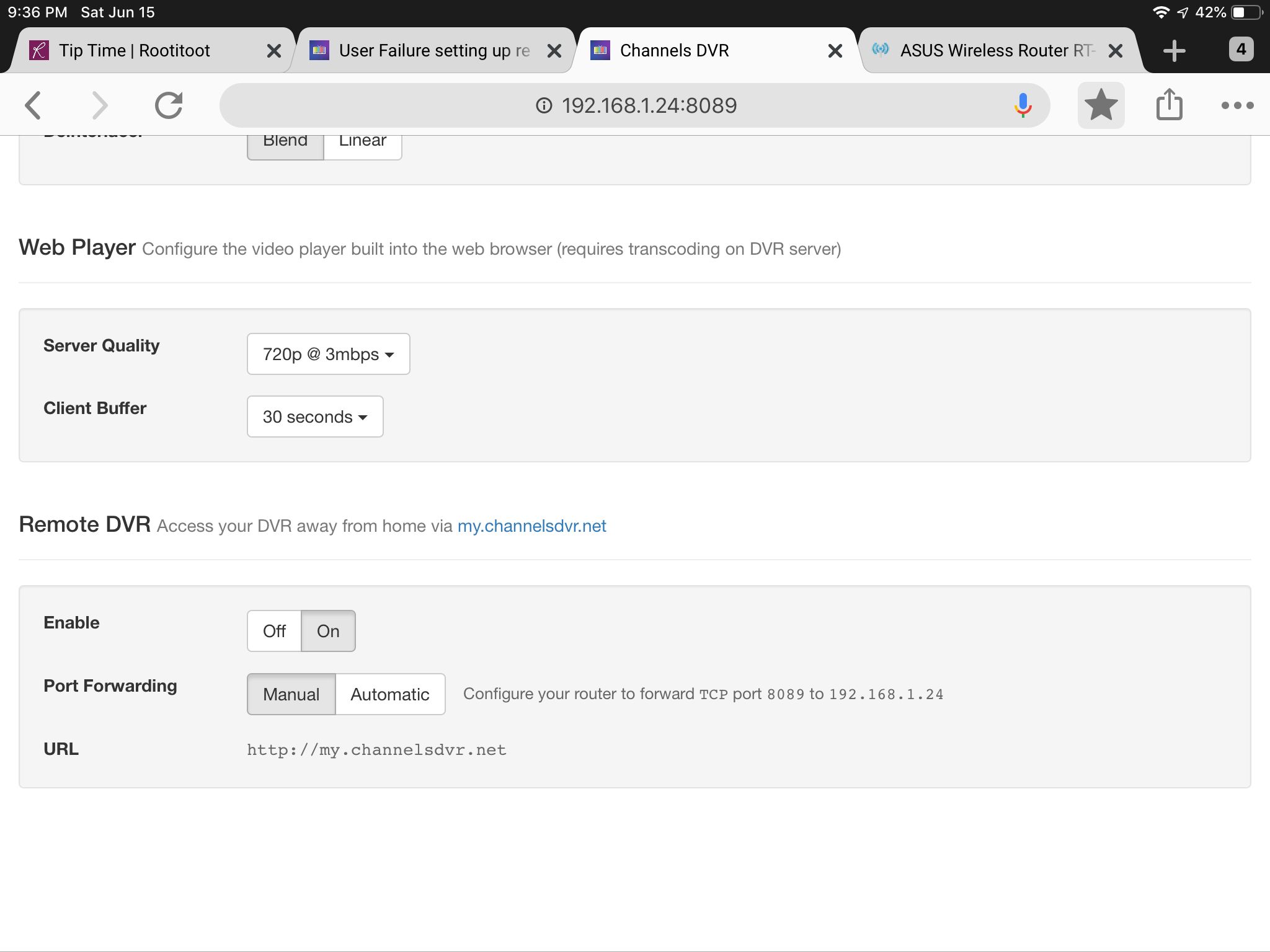

I am trying to get remote DVR access set up, and keep getting the message that I need to enbable it on the server. I have done this, and saw it defaulted to port 8089 - a good thing. Then I thought I needed to enable port forwarding from any incoming address on port 8089 to the unix box with the DVR server running to port 8089. When I did this and toggled the switch to enable remote viewing, I saw that channels jumped up to the next port. In fact, I started chasing it - opening up ports, and it would switch to the next port, before I realized that maybe I don't need to open the port and that automatic would be fine. So, I deleted the port fowarding options that i created on the router. However, even on automatic mode with no manual port fowarding set up, I still recieved the message that my channles DDVR was not switched to remote viewing. So, I set to manual, and then went back and re-enbled port forwarding to 8089. Still no luck. Any hints?
I am using ASUS RT-88U router, channels is running on laptop with ubuntu linux. Channels is version 2019.04.22.2317. The dvr server is on a static IP on my LAN.
since all that the enable remote does on the DVR is attempts the Automatic port forwarding, i would leave it off on the DVR and just configure the port forwarding of 8089 to your DVR IP. since you had done both, maybe you just need to reboot your dvr real quick after this and see if that doesnt clear it up?

When I press on the link displayed to set enable the channels DVR, the link ( Visit http://dvr-desktop-ic47ve5.local:8089 while at home to enable the Remote Access option.) leads to: dvr-desktop-ic47ve5.local ’s server IP address could not be found.
DVR Settings shows: Listening on {myexternalip}:8089
Portchecker shows port 8089 is open on {myexternalip}
The router shows my external ip is consistent with portchecker and the DVR settings.

That was it. I did not realize how closely a user account on the community was linked to the actual operation of the dvr.
