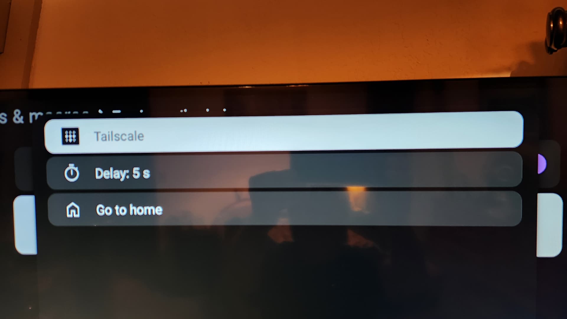

So, back when this thread started, I was going to recommend tvQuickActions Pro. I use it to auto start Tailscale whenever my Android client boxes reboot. My actions are a bit less sophisticated (complicated?).
