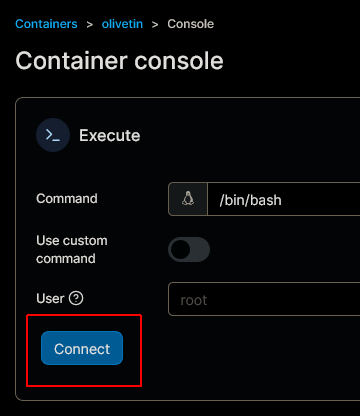

I definitely want to get to the bottom of this outlier issue as well. Out of curiosity, if you exec into the OliveTin container using Portainer's Quick Action buttons are you able to ping youtube.com?

For those users unfamiliar with this
Screenshot 2025-01-11 at 08-51-52 Portainer local

Doing that is probably the best way (Use www.youtube.com, since that is what your code uses and youtube.com resolves to a different IP). It will result in getting a 403 Forbidden error when the token URL expires because of the skipped refresh.

Thank you @chDVRuser and @bnhf. I'm not sure what did it, but after a couple of tries, it is working now. I was able to ping www.youtube.com using the Console in the OliveTin container. I copied the M3U from @bnhf from a few posts up, which added the Big Sky stream to his three. It still didn't work, giving me the same error.
