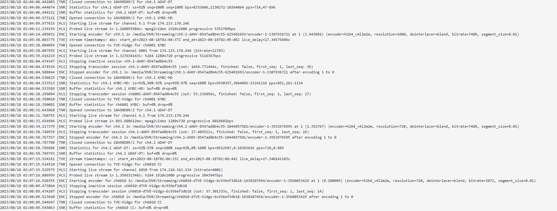

Nothing really sticks out on the server side in the logs to me. I do know it’s not 2am tomorrow in Kansas City. So your server time click is wrong but I wouldn’t think that would cause this. What is your server running on?

Etc/UTC
Should i save it to something in the CST zone?
I don’t think it matters. I have mine to central so it’s easier to look at logs. I just tested my kc fox 4 at 8MB and it loads in 6sec.
2023/08/17 21:18:14.958369 [HLS] ffmpeg: ch4.1-dANY-b3e016ba56c7-1-hevc-aac-copy--7232-384-720-6-0--hardware-false-false-0.01-0:  [hls @ 0x92c3ac0] Stream HEVC is not hvc1, you should use tag:v hvc1 to set it.
2023/08/17 21:18:34.160342 [HLS] Stopping transcoder session ch4.1-dANY-b3e016ba56c7 (out: 22.067911s, finished: false, first_seq: 1, last_seq: 21)
2023/08/17 21:18:34.167434 [ENC] Stopped encoder for ch4.1 in /home/rice/DVR/Streaming/ch4.1-dANY-b3e016ba56c7-2436431808/encoder-1-1059132197 after encoding 1 to 19
2023/08/17 21:18:34.177184 [TNR] Closed connection to 10804B89/2 for ch4.1 WDAF-DT
2023/08/17 21:18:34.178291 [SNR] Statistics for ch4.1 WDAF-DT: ss=100% snq=100% seq=100% bps=9424610,4484928-13937568 pps=807,384-1193
2023/08/17 21:18:34.178302 [SNR] Buffer statistics for ch4.1 WDAF-DT: buf=0% drop=0%
I would change deinterlacer to hardware and If it doesn’t improve I would submit diagnostics from the phone app from a cell connection and post back here that you submitted

I meant on the server side. Your logs show your deinterlacer is on blend
