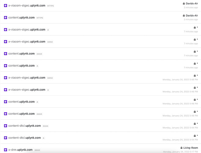

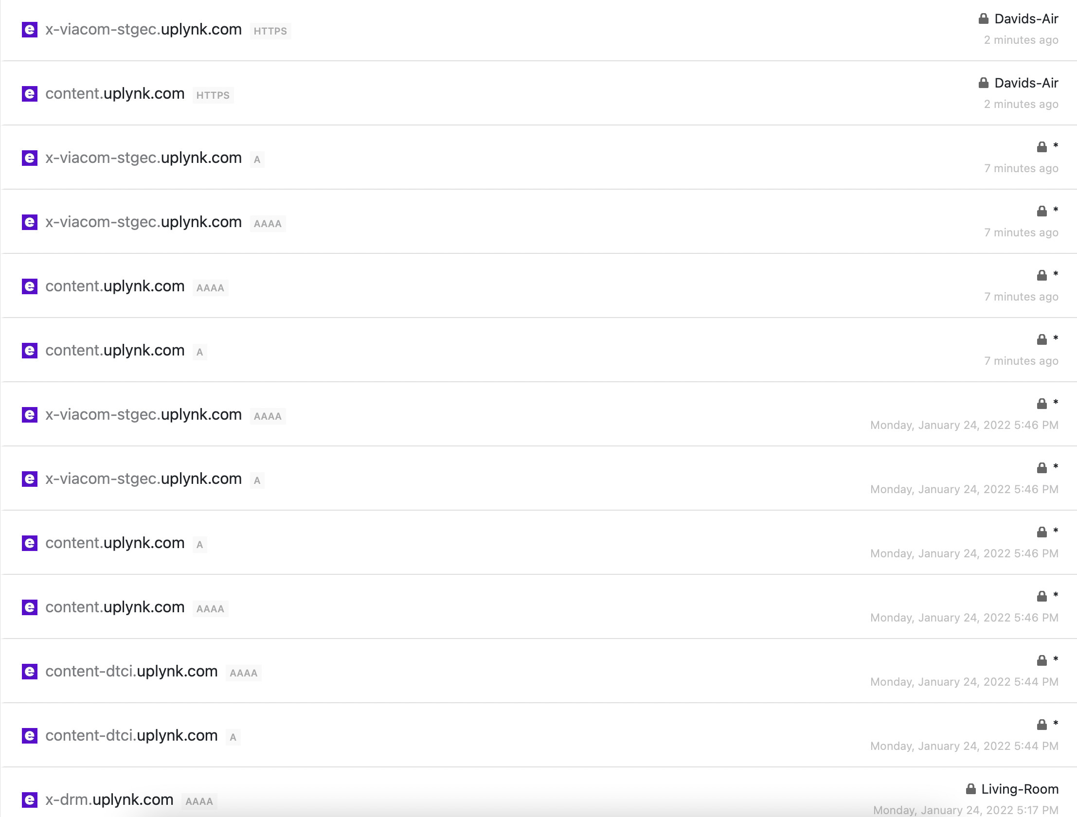

DNS logs are showing that's getting through fine.
Yea but what IP is it resolving to. If it's sending you to the IP of a server that's halfway across the world, then ofcourse its going to be slow. When you use ISP DNS it resolves to the IP of a server that's in the ISP datacenter, which is only a few milliseconds from you.
If you want help you're going to have to be more explicit about what kind of DNS system you're using and how your network is setup. From your screenshot it appears to be intercepting HTTPS as well, which would explain some of the delays shown in our logs. It's also resolving AAAA so its possible you're seeing slowness streaming over ipv6 and your browser is only using ipv4.

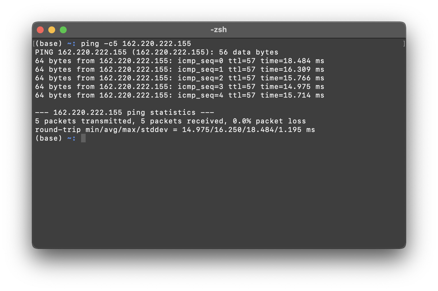

The HTTPS were me testing MTV from my browser. I'm using NextDNS as the filter, but they resolve to the closest location, which for me is Denver. Here's my ping to their server - averaging 16ms RTT. And yes, I have set up IPv6, but that wouldn't cause this issue.

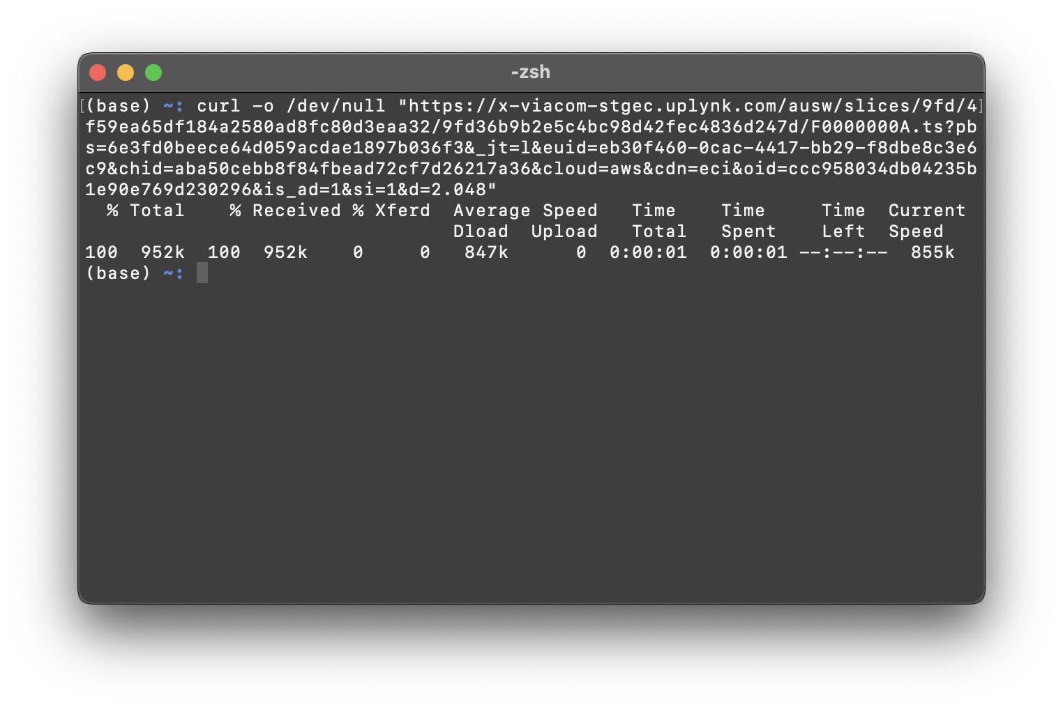

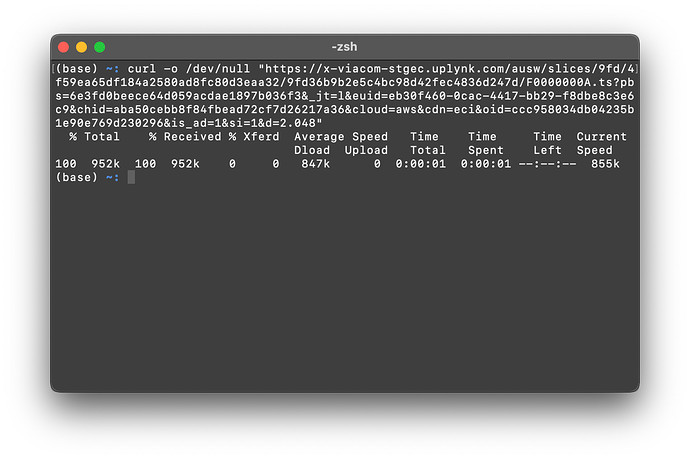

Maybe try curling the url that's failing/slow and see what kind of speeds you get:
curl -o /dev/null "https://x-viacom-stgec.uplynk.com/ausw/slices/9fd/4f59ea65df184a2580ad8fc80d3eaa32/9fd36b9b2e5c4bc98d42fec4836d247d/F0000000A.ts?pbs=6e3fd0beece64d059acdae1897b036f3&_jt=l&euid=eb30f460-0cac-4417-bb29-f8dbe8c3e6c9&chid=aba50cebb8f84fbead72cf7d26217a36&cloud=aws&cdn=eci&oid=ccc958034db04235b1e90e769d230296&is_ad=1&si=1&d=2.048"
Does the Activity Monitor on your mac show cpu, ram or disk approaching 100%?
No, CPU < 2%, Memory 30% free (using 5.15/8GB), main hdd has 142 GB free, DVR hdd has 21TB free.
