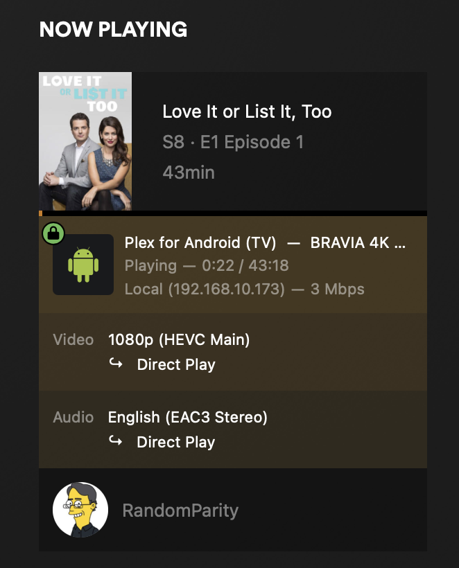

Tested results:
  1. Viewed same content (EAC @ 44.1kHz, dual channel) on Plex running on the same TV. No stutter. Plex reported direct play (no transcoding on the server).

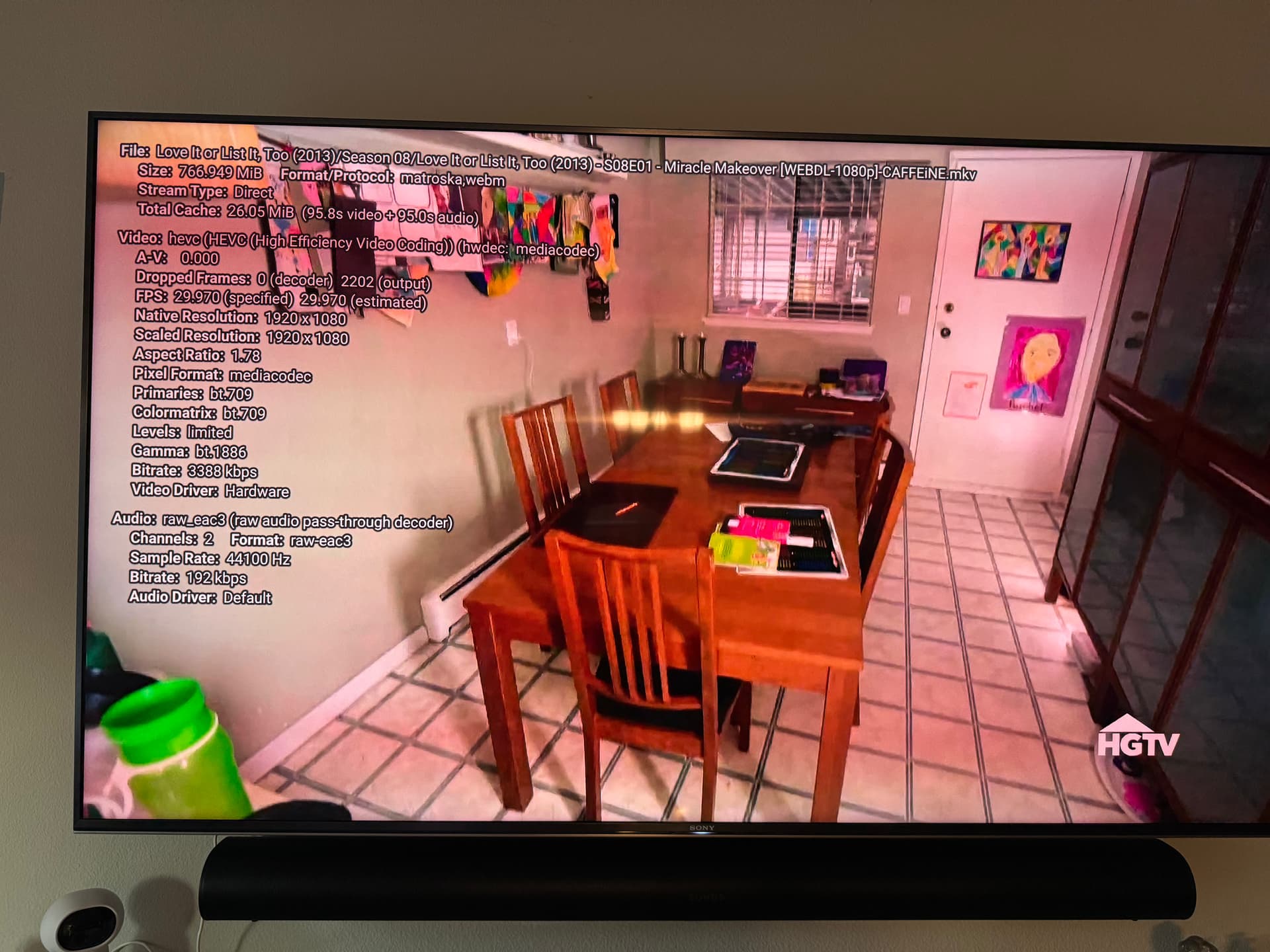

What does the in video stats overlay show about the audio rate
Here's s photo showing the stats:
After letting the video run had to restart the TV as the sound bar (Sonos ARC, connected by HDMI eARC) lost audio.
Sounds like its a TV firmware issue, where AC3 passthrough isn't working with 44.1kHz
