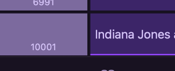

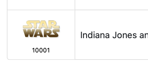

I've created a virtual channel successfully, but can't get my channel logo to show up in the GUIDE. I'm using the sample "Star Wars" image from the support page as a test. It does show up in the guide in the browser when configuring the server - just not on the AppleTV app.

Ah, ok. I was referencing it not showing up in the guide/
If you uploaded it via the latest Channels DVR Server update, but don’t have the latest client, then it would explain it.
That was worth checking but everything shows up to date.
Server is 2022.03.23.0209, client on appleTV is 5.2.4
Screen Shot 2022-03-23 at 4.57.55 PM
Screen Shot 2022-03-23 at 5.00.50 PM
Did you upload the image or enter it as a url? Is it an http or https url?
If it's an upload then you would need beta app or wait for v5.3.0
Well there it is! I uploaded it. Doh. Thanks, I'll try to point it to a URL.
Thank you all for helping me troubleshoot!
Worked immediately! Thanks again, sorry I missed that caveat.
