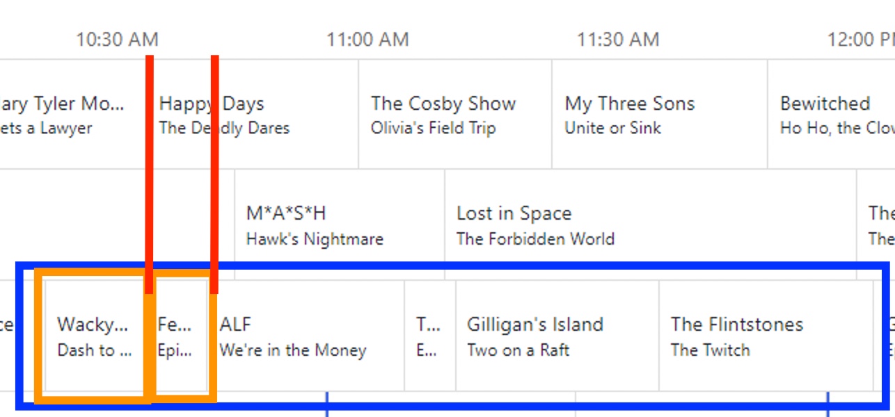

Several of the shows are cartoon sources, so episodes can range from a few minutes to up to 30 minutes (see attached screenshot).
I wonder if this is causing Channels to try to compensate backwards in error, instead of forwards.
