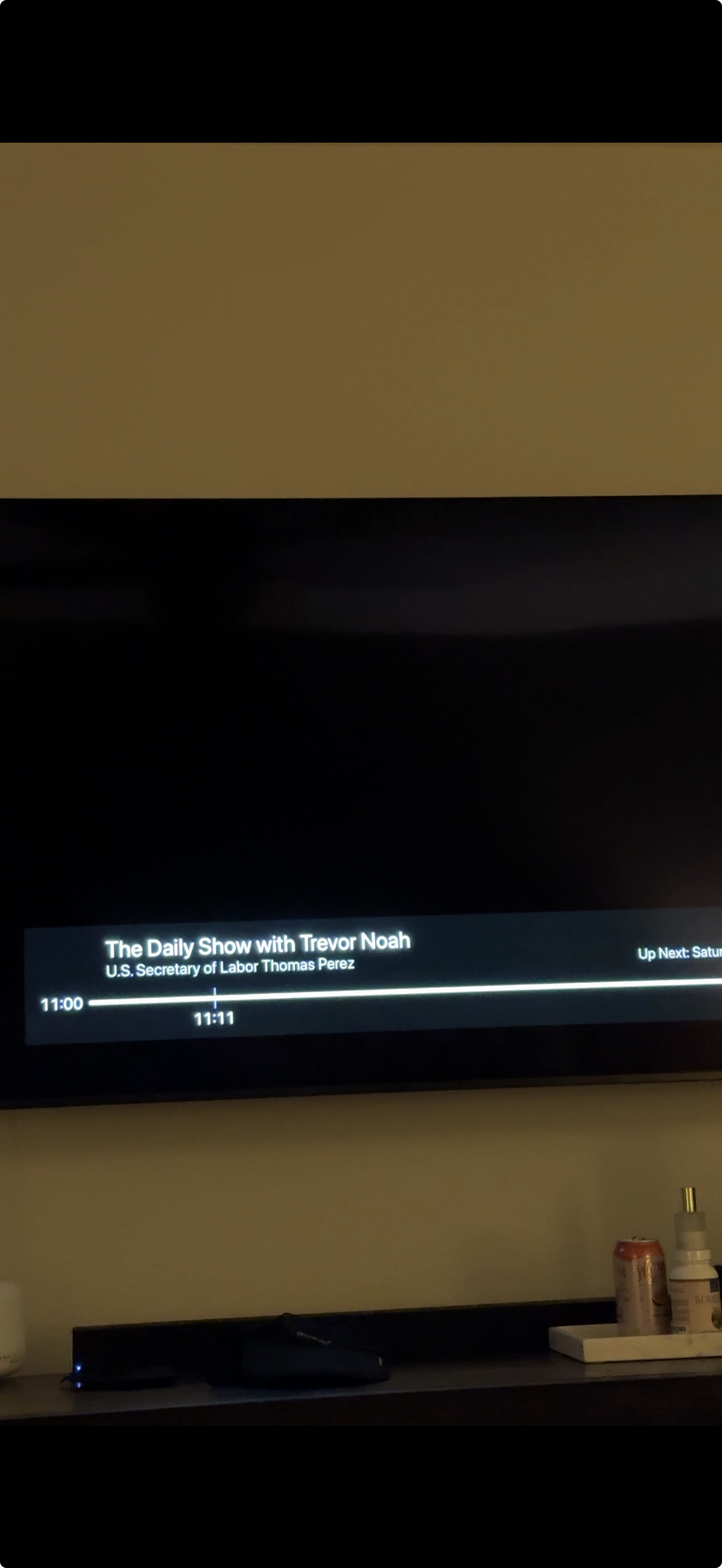

@maddox @tmm1 I’ve noticed that when I press on a Virtual Channel and then soft-tap the remote while it’s loading (I’m doing this to confirm it’s not a Match Content issue), it looks like it’s briefly pulling from one of my real channels that’s linked from YouTube TV. For example, The Daily Show will flash on screen for a second before moving on to the actual Virtual Channel. I uploaded a video.The example is on my Central Inteligence test
Also the Daily show with Trevor Noah is not even on right now. Its like its referencing an old episode or recording cause youll notice it says Up next: Saturday night Live. But i dont have that in my recordings
Somehow its trying to play this first every single time I play a virtual channel. It flashes first before moving on to channel. @tmm1 @maddox

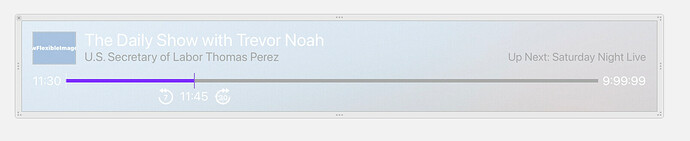

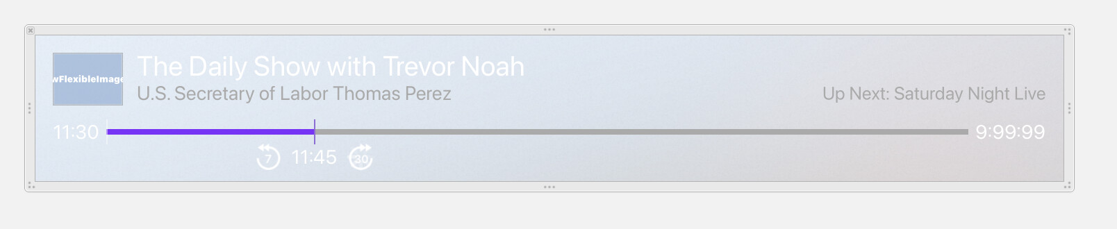

:rofl: you're just seeing the timeline in it's default state before rendering with what's currently playing. Here it is in the dev tools.
I don't think this has ever come up in like 10 years. I've certainly never seen this.
