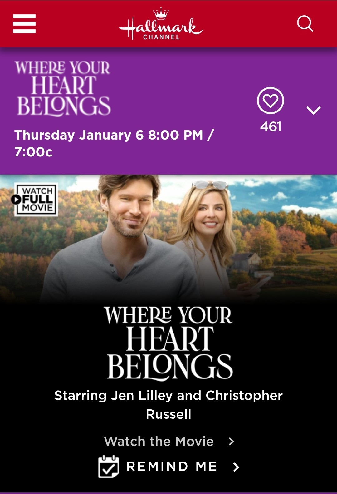

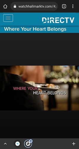

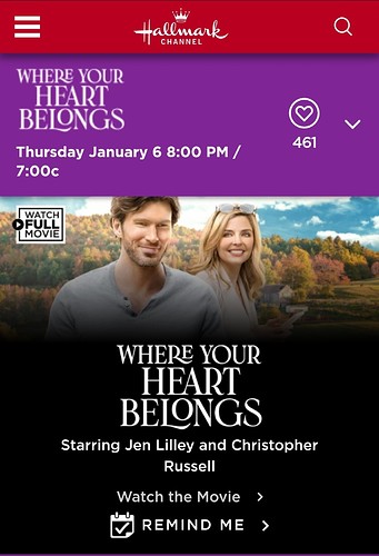

I just realized that Hallmark has some movies that you can watch on demand right on their website as long as you are logged in with your TV provider.
In action:
Could Channels provide a way to browse the VOD library and let the user choose the stream?
It seems to me that once the stream has been started, the DVR engine could capture the stream as if it was a live channel.
@maddox @tmm1 @eric maybe a new TVE feature for this year? :wink::wink::grin:
