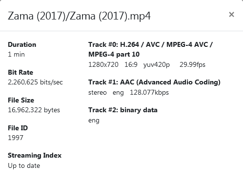

Is there a reason why this Import would transcode instead of remux while playing locally in the web browser?
2021/03/06 19:25:24.285531 [ENC] Starting encoder for Zama (2017).mp4 in /volume1/arkives/ChannelsDVR/Streaming/file1997-ip192.168.1.2-730833072/encoder-0-410525775 at 0 (0.000000) (encoder=libx264, resolution=720, deinterlacer=linear, bitrate=2260 segment_size=0.01)
2021/03/06 19:26:25.484043 [ENC] Encoder stopped for Zama (2017).mp4 in /volume1/arkives/ChannelsDVR/Streaming/file1997-ip192.168.1.2-730833072/encoder-0-410525775 after encoding 0 to 25
Zama (2017) Transcoding

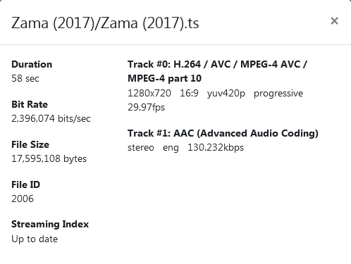

So I remuxed it to an H.264 Transport Stream file and it plays without transcoding or remuxing.
Channels DVR must be confused with it in the mp4 container.
Zama (2017) Not Transcoding
