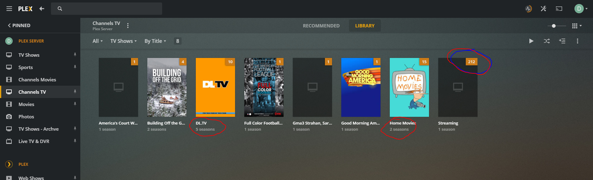

Here is the screenshot. All of these were recorded from channels.
I circled the 3 areas in question. Here is what I am seeing.
  1. The DLTV recording is an episode of Americas Court with Judge Ross. Even though there is another (different) episode that is categorized correctly.
  2. The "Home Movies" are not home movies. They are movies that were recorded from Channels. They do show up correctly in plex under the Channels Movies library I setup. They are showing up here in the TV section has home movies.
3.The last one just shows as "Streaming". This is also an episode of Americas Court with Judge Ross. It is one show that is made up of a few several second 'episodes'. Notice the 209 new show marker at the top This is mainly what I meant was gibberish.
It seems that some of them of working as expected, but not all of them. Is this to be expected, or do I have something configured wrong? Thanks for taking a look.
You've added the wrong folder to your plex library. It should be pointing to B:\Channels\TV
Such a simple solution, I actually had B:\Channels and B:\Channels\TV on that library. Once I removed the B:\Channels it is now showing as expected. Thank you for the help.
