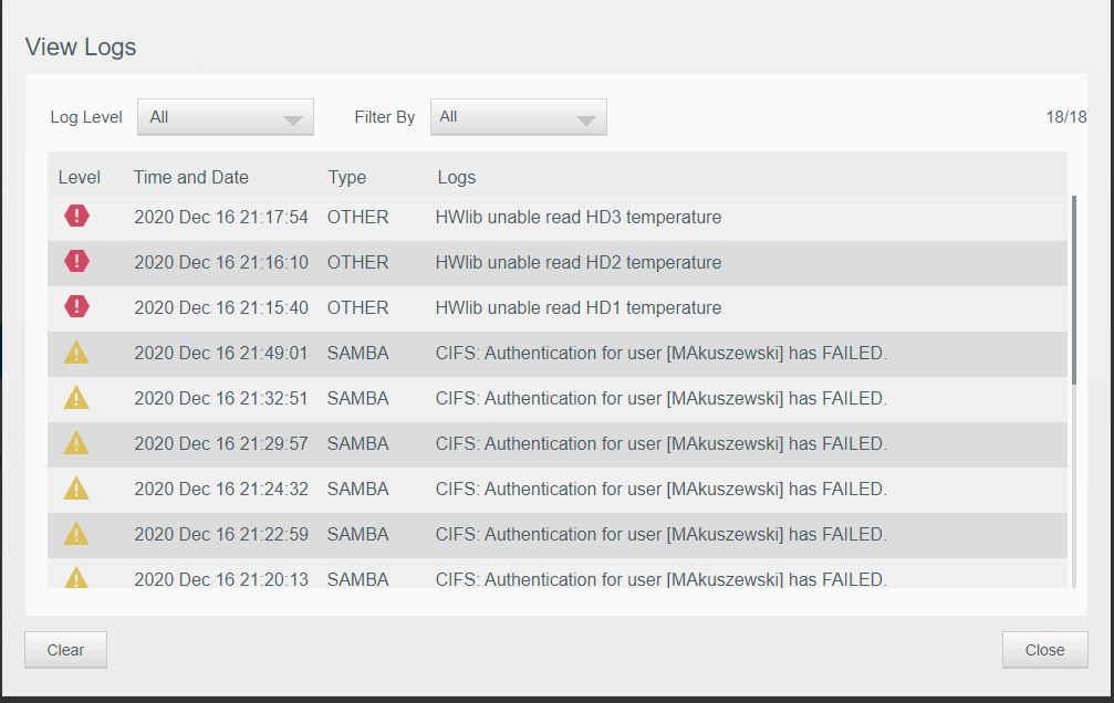

Channels rus fine, but the WD NAS locks up and crashes after an hour into a movie. This the typical log error I see after reboot.

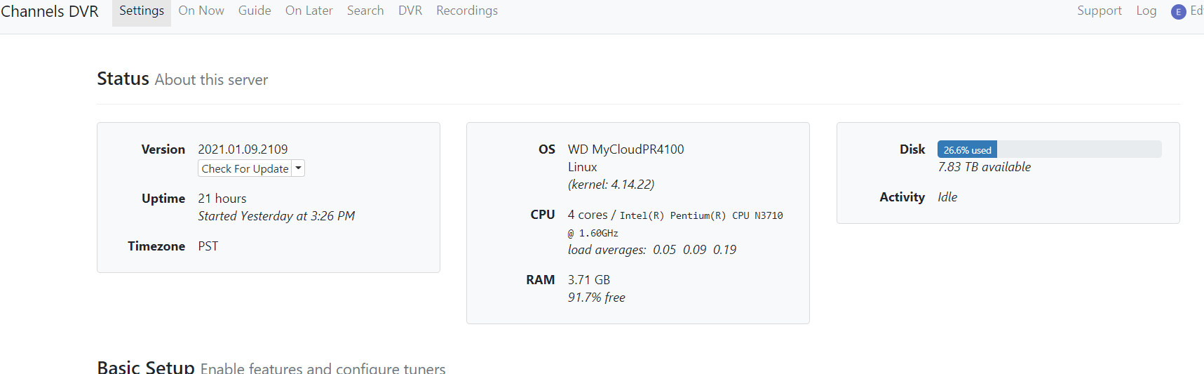

I also run the HDHomeRun DVR on it.

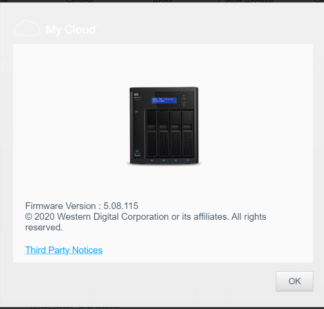

I have been fighting with this thing ever since the new OS. What am I doing wrong then?
Firmware - 5.08.115 OS - 5

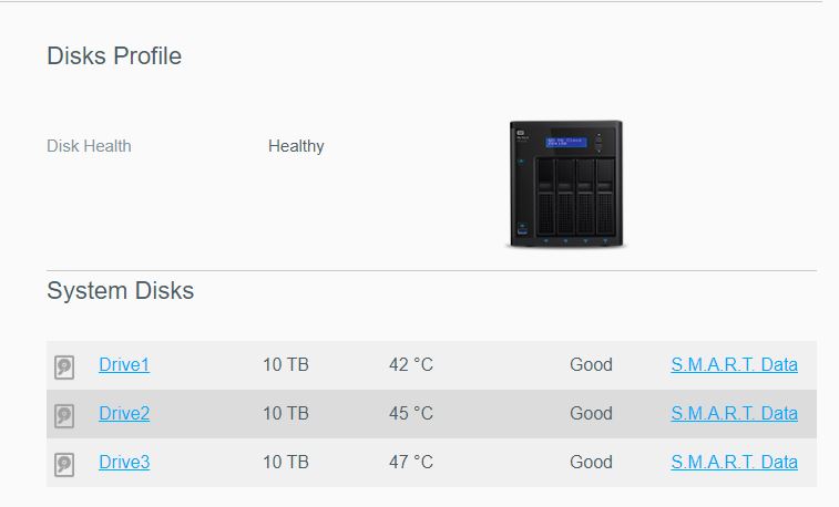

That is a great NAS maybe somehow your file system got messed up what kind of raid are you running on it?
Volume_1
RAID 5
11.89 TB
Good
