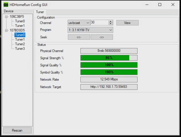

If you download the 'tech software' you can use it to view the channel stats in realtime when the tuner is in use. Have you tried that to confirm the signal is really fine when being tuned to the ATCS 3.0 frequency?
Here is a snapshot of it:
