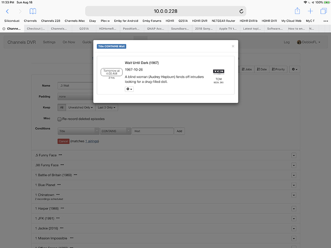

Here are some screenshots of a broadcast listing in web UI: Notice 2 Channels Avail
- From Advanced Passes:

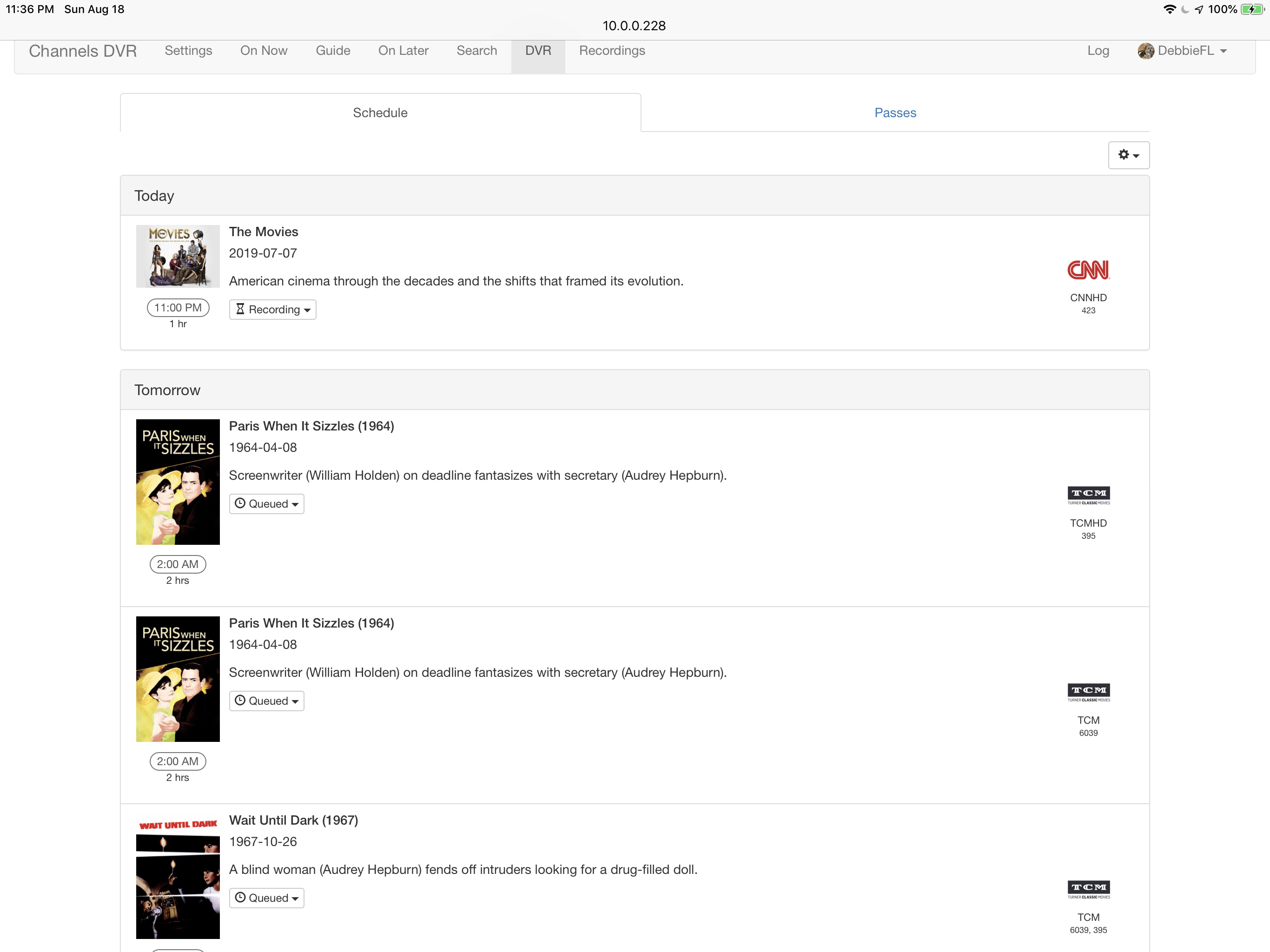

- From DVR Schedule (last one)
I was not able to record 2 separate recordings recordings like: (Paris When....) earlier. However, the DVR schedule also didn’t show 2 either. Set both of these from Guide (I do have the 2 different channels showing (due to my intended setup) DVR isn’t really designed for this ...and I don’t think 2 recordings will work. No harm in trying
Might be surprised!.
Interesting.
"In Theory" if 395 is from your Prime and 6039 your TVE, then it would depend on which of the two channels you favorited and the tie breaker should be which device is higher priority since both channels appear to be HD.
Would be very surprised if it actually recorded the same movie at the same time from two different devices.
It does not record the show 2 times ... It favors what ever device you have as the highest Priority in the DVR... or what ever channel the show starts at an earlier time.
All of us were wrong:
The recordings were both distorted (expected on 6039; problems already ID on Qnap 251A)....however, we had had transmission problems all day with IP (Xfinity) and supplier of both feeds (395 (Prime) & 6039 (TVE)). Base transmission continued on next recording...(set by accident).
I had expected that both would “start” but would probably have problems (See my prior observation of both entries in Logs/Schedule). I’ll re-run test again...just to see if 395 records cleanly.
