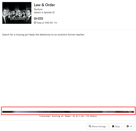

I'm having a problem watching recordings from the web UI with Windows 10. I start the recording and everything is fine. The transcoder speed using hardware is around 4-5x. Next, I use the scrubber bar to move forward in the program. When I do this, the transcoding speed drops to less than one and starts using 100% of my Intel i3 3225 CPU power. The task manager shows 7-10 ffmpeg.exe processes spawned by Channels with each one using 5-20% CPU. Even if I stop playback, those processes keep going unless I end them using the task manager or reboot the PC. This is repeatable for any recording. If I hit the Stop button before using the scrub bar, then the ffmpeg process ends and my CPU load goes back to normal.

I tried single clicking on the scrub bar and this did not cause any issues with CPU load. In the previous example, I clicked and dragged the scrub bar to the time I wanted. I think the click and drag is being interpreted as multiple clicks by Channels.
Great catch, I can reproduce as well with click-and-drag. Will fix for the next build.
