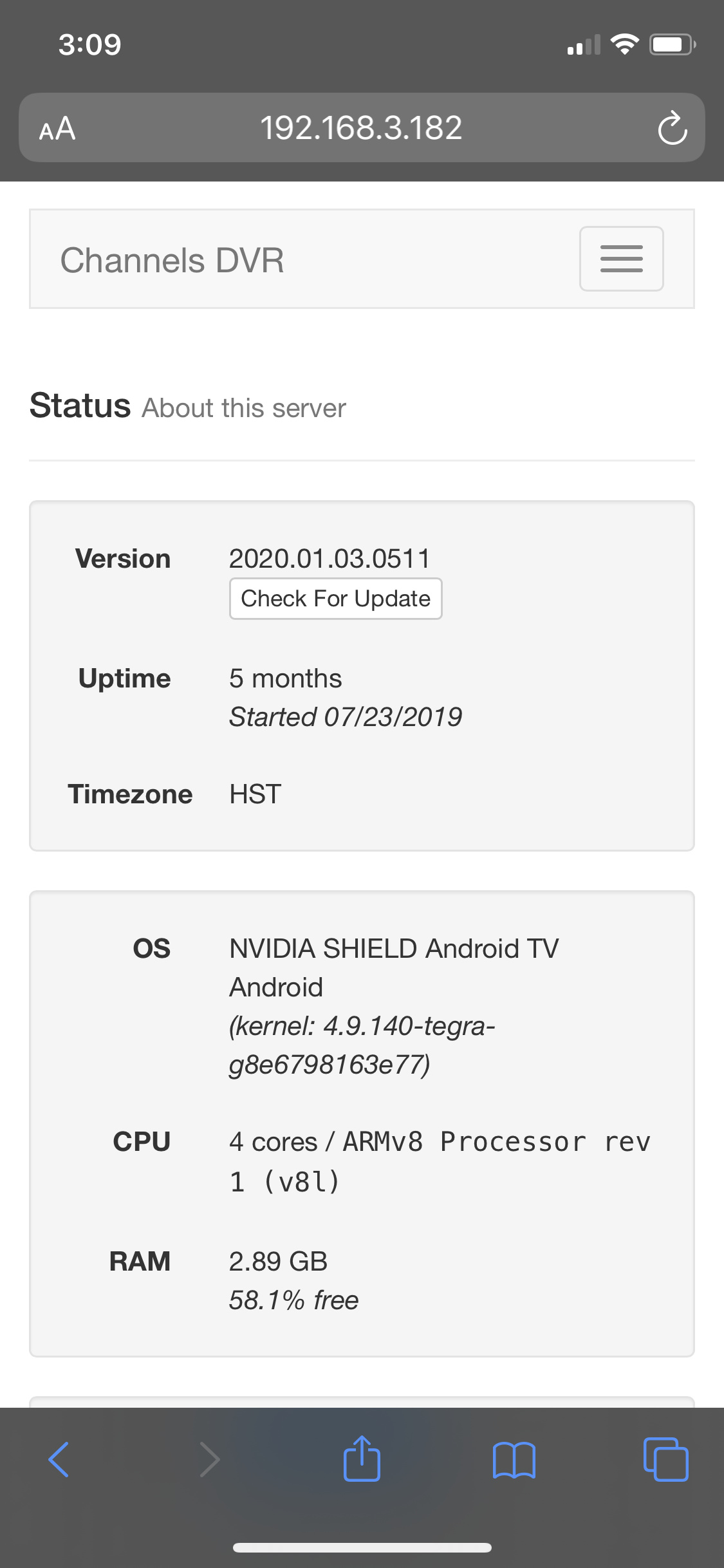

This is the wrong date?
Exactly, which is apparently a symptom of the problem!
I’m thinking it has something to do with the remnants of the older DVR Server I had on here before you advised me to move it to a new external USB Hard drive attached to my Shield. I believe you told me this sometime around that date. Coincidence?
When it suddenly starts working correctly, the date and time are correct.
You can see in the logs I posted a few posts up where the date is correct and then it reverts to the 7/23/2019 date when all the issues resurface.
Here is where it transitioned:
Sounds like the clock on the shield is failing. Could be a hardware failure. That explains the other weird issues too.
No I do t think that could be related. It's saying "starting 2020.01" but the date is 2019.07 so the clock on your shield is broken.
