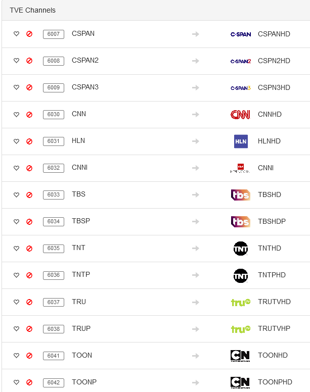

If you want to disable a TVE source temporarily but keep your favorites, just disable the individual channels in the TVE source on the Channels DVR.
Ugh, don't try that. Doesn't work like you think it would.
Even though Channels has favorites(hearts) and disabled(red-slashed circle) selections in separate columns, it doesn't work that way.
It works the same as the HDHR channel selector.
If you disable a channel in Channels DVR it also removes it as a favorite.
