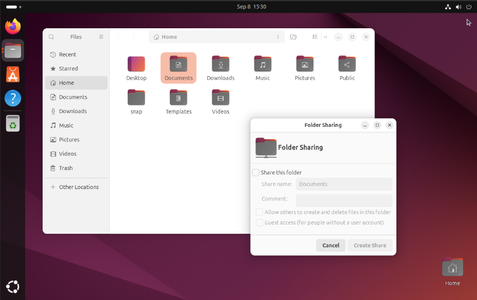

If it was Samba, it's pretty easily done through the Desktop GUI. If it was Ubuntu Server, I'd install cockpit, cockpit-navigator, cockpit-file-sharing and cockpit-identities and do it all (Samba or NFS) through a nice WebUI. But, installing cockpit can be tricky on Desktop, so hopefully somebody else will know a set of working steps.

He just posted he wants to use NFS and he's running Ubuntu Desktop. He can do Samba from the Desktop GUI:

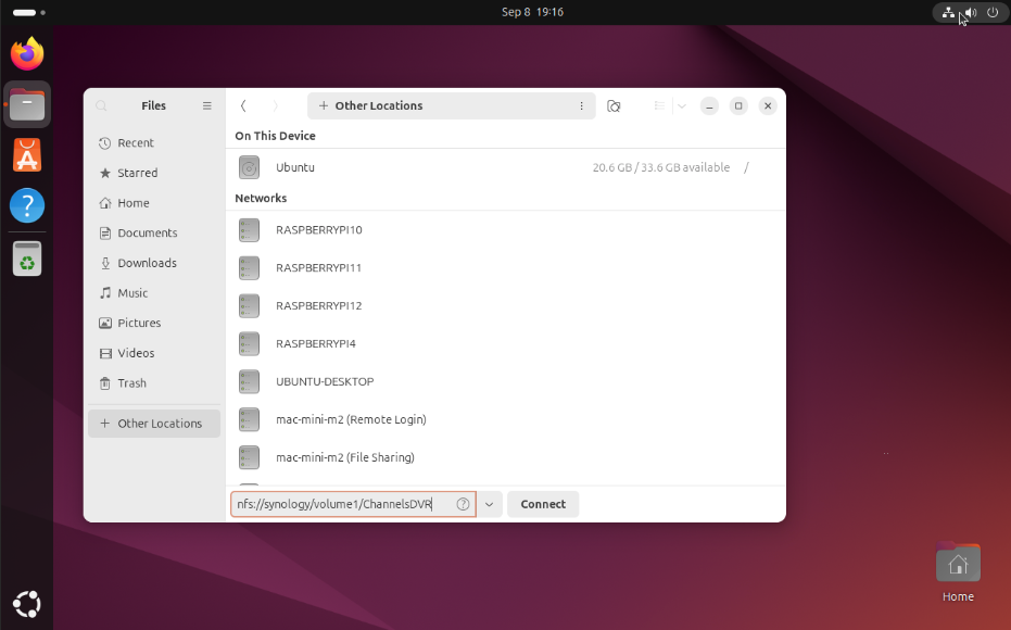

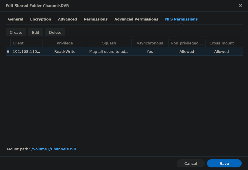

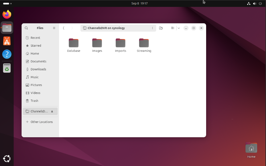

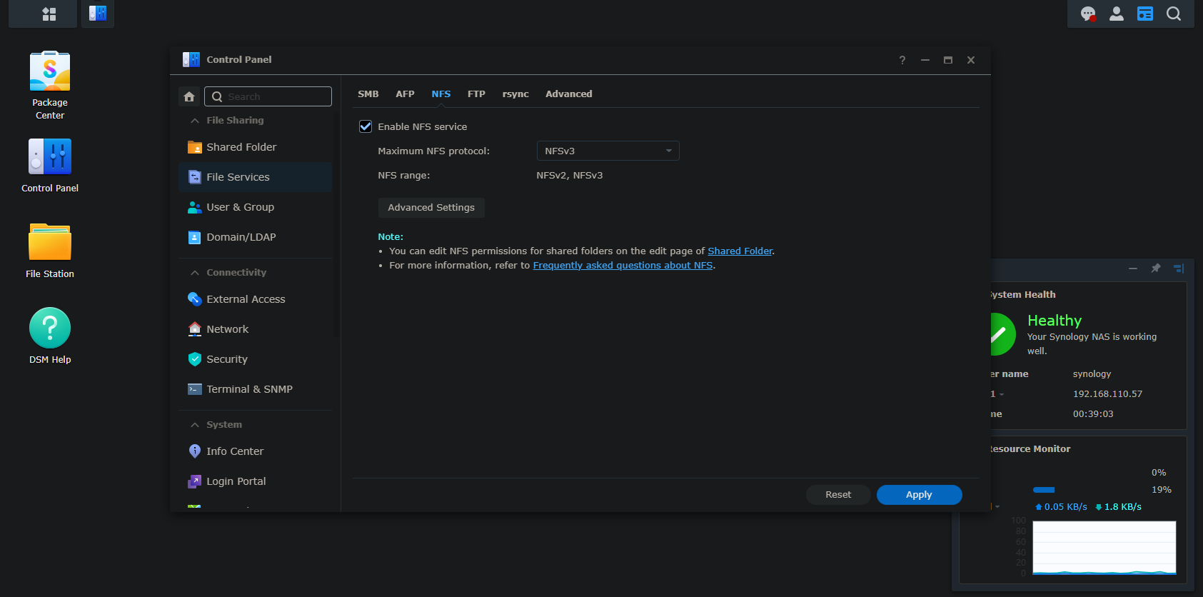

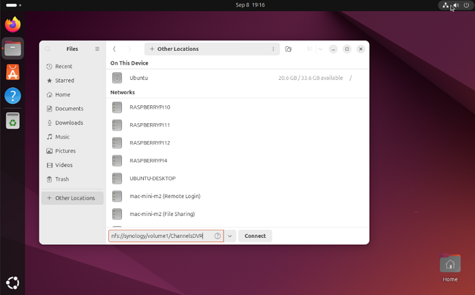

It can all be done from the Synology WebUI and the Ubuntu Desktop GUI. I played around with this while watching football, and it's not too difficult -- although you'll probably want to tighten up permissions:
Synology:
Ubuntu Desktop:
Thank you, it worked! Bad news though.. when I changed the directory for the movies, it started to import all of my movies again so now I have a bunch of doubles, I’ll have to restore it back to a few minutes ago.
