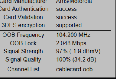

Interesting...so these are the readings from one of my Primes:
OOB Frequency 75.250 MHz
OOB Lock 2.048 Mbps
Signal Strength 90% (-6.3 dBmV)
Signal Quality 100% (34.5 dB)
of course this is right now and not at the time of recording.

Yours looks good.
CableCARD Status
Card Manufacturer Arris/Motorola
Card Authentication success
Card Validation success
3DES encryption supported
OOB Lock 2.048 Mbps
Signal Strength 91% (-5.6 dBmV)
Signal Quality 94% (29.4 dB)
Channel List cablecard-oob

gotcha...i guess i need to look and see if i can shorten the run...do my numbers look good in the sense that i shouldn't see any pixelization?
Not sure my numbers are much higher than yours maybe a cable expert can chime in.
You can check the DVR logs to see what the signal numbers were for the affected recordings
Roger..will take a look
@Catfish the screenshots you posted are fine. No need to replace any cables based solely on that. Typically you want to be -10dBmv to 0dBmv on the downstream. However you should make sure you don't have any radio shack splitters, distribution amps, walmart coax, etc. As @tmm1 said, check the logs and see what Channels is saying the issue is. If it is signal related I would try and repro on a TV if you can (if you have one that has a VZ Fios box). It could be an intermittent problem with the HDHR, ONT, cabling etc.
