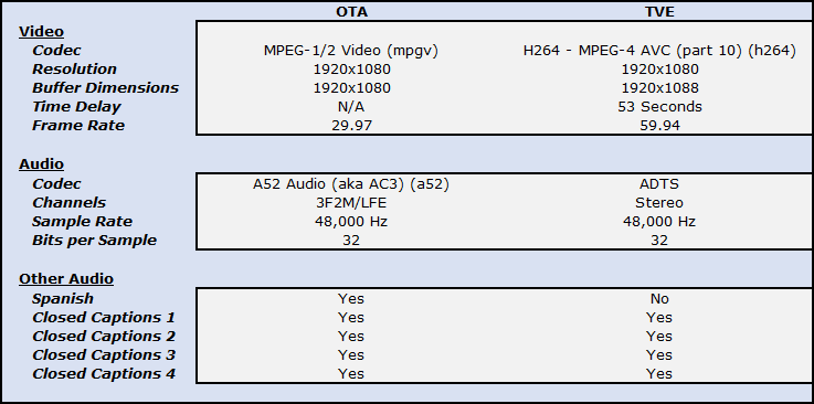

My local CBS recently became available again as a TVE channel for me, so I was trying to decide whether to make it my default over the OTA channel. I thought I would just do a side-by-side comparison in VLC to see if I could notice any differences quality-wise (couldn't really tell), but while I was there I captured some other pertinent details:
I live within 5 miles of the tower with good line of site, but there are occasional drops and issues, especially in a densely packed area. ATSC 3.0 will not even start to become available until late Summer at the earliest, so that is not a consideration at this moment. I do prefer the overall stability of TVE and find it works better when remote, but that time delay is very annoying.

OTA 5.1 Sound TVE Stereo sounds flat on my entertainment center.
OTA wins on specs. I have OTA with first priority when recording.

Quality - Despite the specs shown, both the TVE and Cable (Spectrum) are highly compressed. This is very noticeable on some broadcast content.
Audio - AC3 > Stereo

CBS seems to be a outlier in that their TVE feed is 1080p/60. Locally for me, FOX and ABC are 720p/60 but NBC is 1080/30 in their TVE feeds. That said, I watched the CBS TVE feed of the AFC championship and it was outstanding compared to the OTA feed. I didn't need 5.1 so the choice was easy for me.

Not only does OTA have much high video and audio quality, but is far more reliable in Channels. Comskip also runs much faster on the mpeg2 streams from OTA. And detects commercials better.
