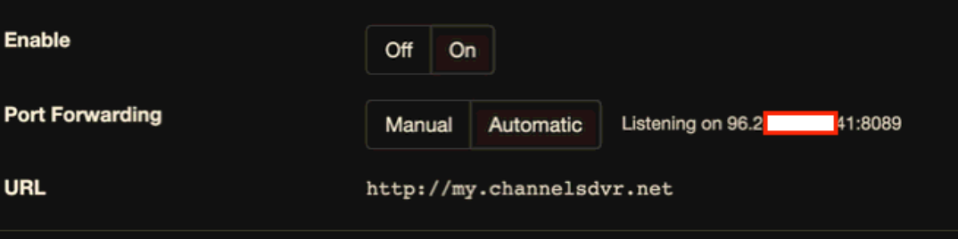

Well, I changed Channels server to Automatic. However, after finishing watching an episode, nothing worked again, even though Channels server was not reporting any issues...
So, now I will change to Manual and forward the port through the router, but waiting for Team Viewer to let me back in since I have used the max log ins with TV and have to wait! Arrrgghh!
@tmm1
Manual port forwarding works. I wonder why Automatic is having problems even though it says it listening on 96.x.x.x:8089?
My concern is that since my router is assigning IP addresses dynamically, I might lose that forwarding in the future. Would prefer to use Automatic.
Automatic seems to be fully working now. I changed it back and so far, so good.
