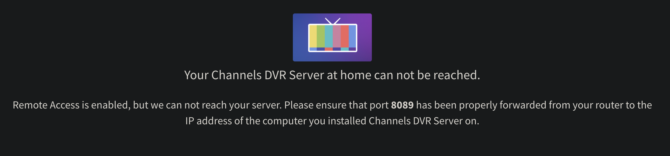

I am very frustrated that after a few hours, I have to constantly log in to the server. And when I do I get the attached screen shot error.
So I access my home computer via Team Viewer and log in. And after about 5-10 minutes, I can use Channels remotely.

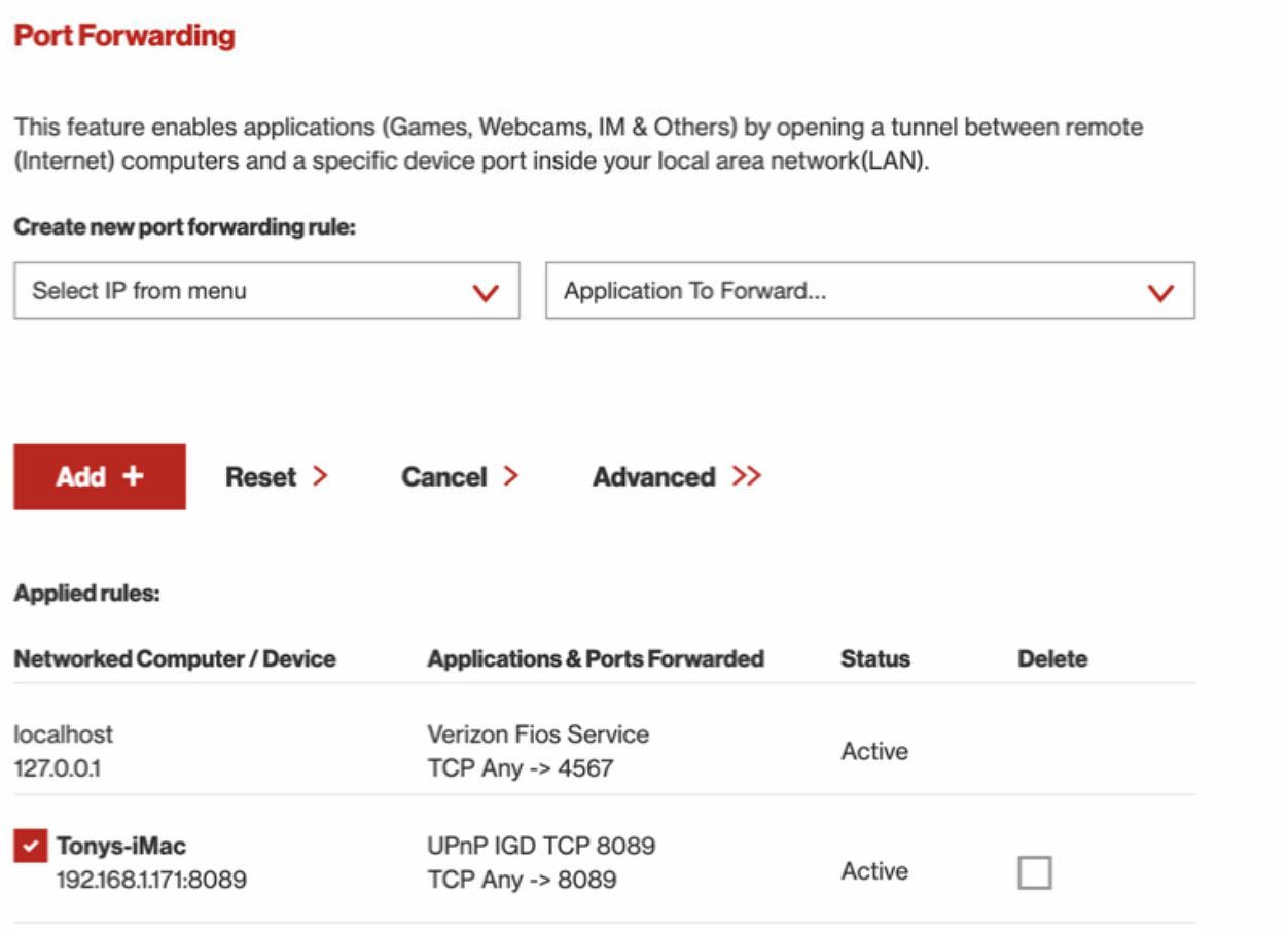

How do you have your port forwards set up? Firewall rules? Any on the server, or all on the router, or both?
I have it all set up correctly, right?

The only thing that comes to mind is that your Mac's IP is changing, so the rule first created via UPnP is no longer accurate.
You may want to set up a static IP/DHCP reservation for Mac on your home network, and then set up a manual port forward for port 8089.
(UPnP and NAT-PMP have always caused three times the problems they ever tried to solve, so those protocols are disabled or not even installed on the routers I set up; you will probably find your network works better without then, too.)

Please submit diagnostics from the app when it fails to connect. When that happens, are you able to connect via my.channelsdvr.net in a browser?
Submit diagnostics from the Apple TV Channels app?
And, no, I cannot connect via my.channelsdvr.net.

Can you connect via teamviewer and then try my.channelsdvr.net again before you toggle remote access off/on
Okay, will try. I just sent a diagnostic report via Apple tv Channels app. (No connection again!)

I tried to access my.channelsdvr.net on my computer outside my home. The browser times out (see below screen shot).
So, I just toggled off/on Remote DVR on my home computer (remotely using TV), and about 10 seconds later, Channels app on my Apple TV outside my home is working normally.
Okay that indicates an issue with your port forwarding setup.
Earlier you posted a screenshot of your router where a forward rule was added manually? If that's the case then the DVR itself should be set to Manual mode. Or if you're leaving the DVR in Automatic mode, then the manual rule from the router must be removed. It seems they're conflicting somehow.
Ah, okay, Let me delete the port forwarding on the router and allow Channels server to forward automatically. I'll let you know.
