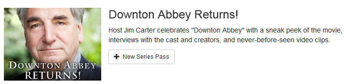

I started recording Downton Abbey Returns late. I selected series pass(only one episode) Will it automatically re record so I can get the full episode. It shows queued.
If it's this one, then yes since it's a special.
A series pass on a special will record it every time it shows since it's not a series.
Yes that’s it. So it will keep deleting and re recording?
If it’s in recordings now, it will probably record the 2x time but not delete 1st.

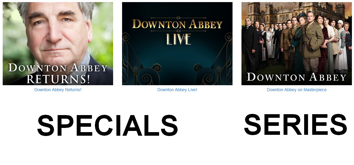

No. https://thebritishtvplace.com/2019/05/pbs-in-june-endeavour-jamestown-downton-abbey-returns/
If you create a ChannelsDVR Series Pass for a Series, it will only record each episode once.
If you create a ChannelsDVR Series Pass for a Special show, it will record that Special show everytime it airs because it's not an episodic series and to ChannelsDVR each airing looks like a different show.
