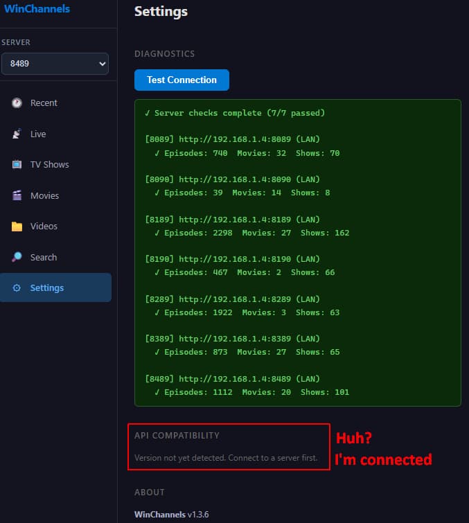

Not sure why I'm seeing this
Version not yet detected. Connect to a server first.
Other than that, everything is working great!
Version 1.3.8 is now available. This one adds an error log and will create a bug report that you can post here. It also (properly) implements an API compatibility check for each configured server, and check for the existence of a new version.
v1.3.8 should provide a better compatibility check.
Thanks, but that just appears to be checking for the Channels DVR Server version, which will change with every prerelease version https://community.getchannels.com/t/dvr-pre-release-notes/28832/9999
There is no way to check the server API version (public documented or private undocumented) as far as I know. And the public documented API (/api/v1) hasn't changed for a long time Channels Support - Server API
