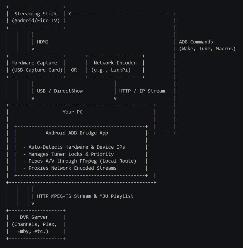

The idea behind this project is it sends ADB commands to an Android/Google TV or Fire Stick device which is connected to either a LinkPi encoder or a USB Capture Device which allows the device to be streamed to the DVR as an M3U playlist.
