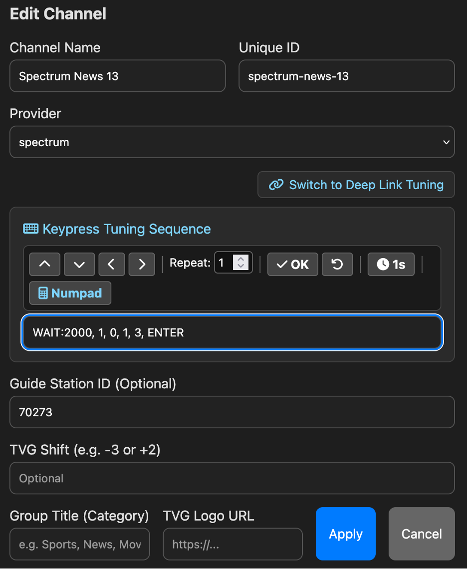

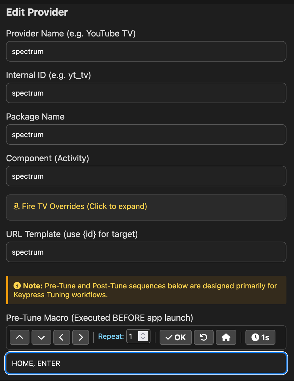

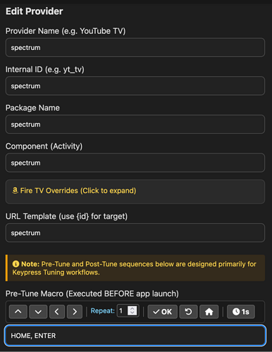

I do not have a spectrum account to test it with. The tuning sequence should fire. The provider pre-tune should be empty unless it requires the home and enter keys before using the tuning macros.
The only difference I see from the pre tune and the tune is I have a string check that looks for words like error that would abort the tune. I am going to upload the next version with the string check removed so we can see if that is what is causing the issue. I'll have it compiled in just a little while.
I have it released as a pre-release. See if this works for you and I will adjust the string check in the final release.
Thank you for all your help. Removing the keypresses from the provider pre-tune and leaving it empty fixed the issue. It is working as expected now. Again, thank you for all your help!

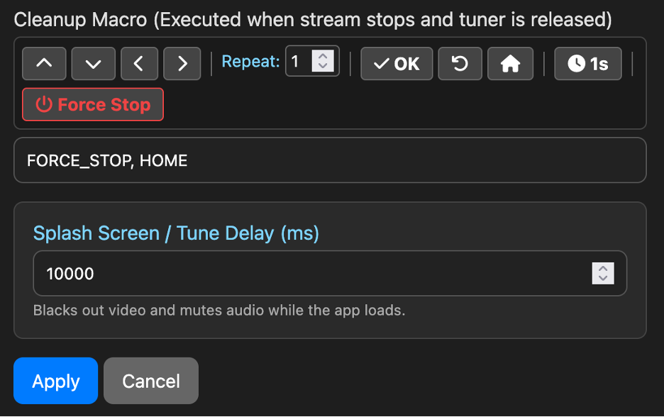

Just tested this with the Onn sticks and YTTV. I did confirm that "Autoplay on start" is set to OFF. When I stop watching a show, the Onn stick goes back to the home screen, then re-enters the Youtube app and continues playing that same show. I added the 'back' button to the warm-up macro, but that just takes the app back to the guide overlay with the show still playing in the background. Is there another way to achieve the warm-up?
I do have a bunch of Firesticks laying around. Would they be a better candidate for the streamers?
You have added a truly impressive amount of features to this tool.
Use Force Stop to close the app. That will give you a fresh start on restart.

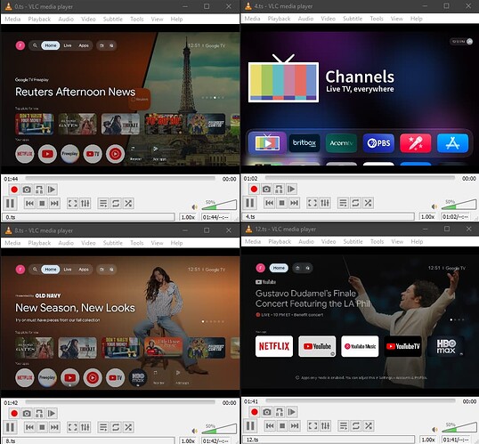

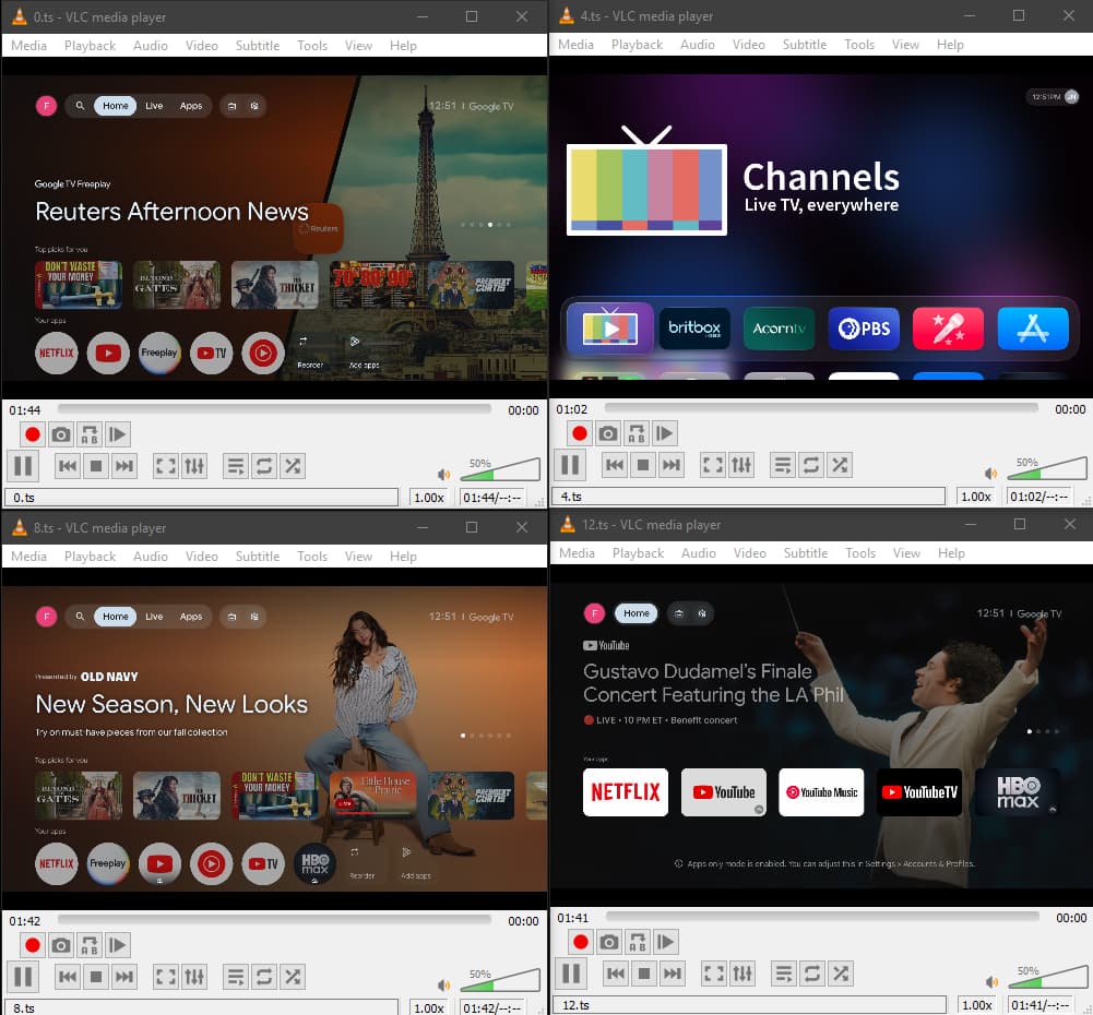

Did you notice any improvement in load time?
