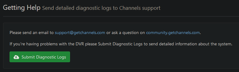

Why wait? Just re-do the actions you described above and then submit diagnostics with a detailed description. That way, the devs can see in your logs exactly what went on when it happened. Here's how:

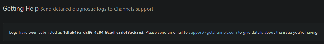

When you click the link to their support e-mail, it will even make a message with the topic being the ID of the logs that were submitted.

Appreciate it, I have submitted the logs. Thanks!
