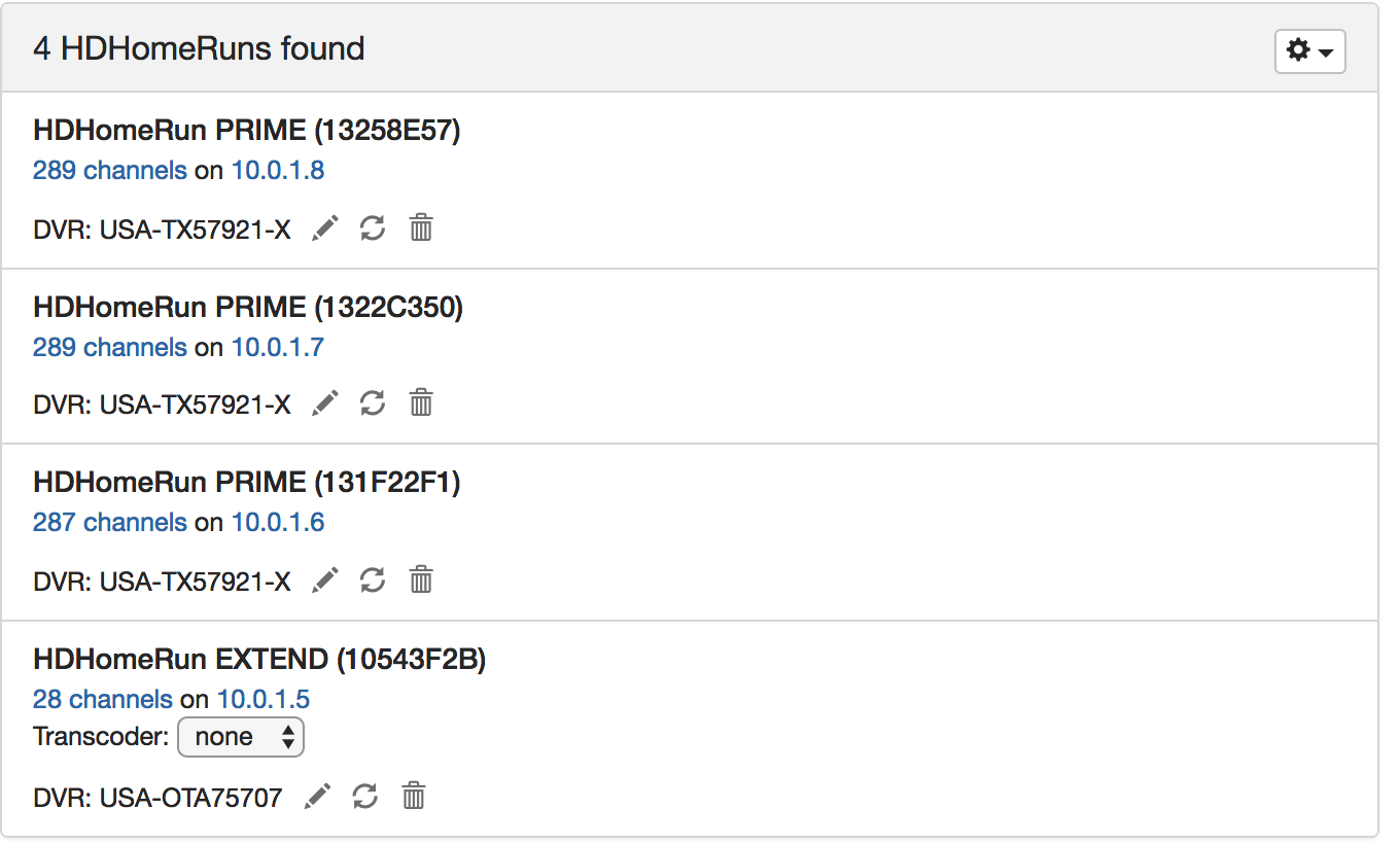

Wrong tuners being used
I have my 3 primes set as priority over my extend because the signal is sometimes weak. For some reason lately the DVR selects the extend over the primes when there are many tuners available. Any thoughts?
For making recordings?
Yes
Can you grab the logs for the recording?
Waiting for it to happen again because it happened several days ago.

Can you screenshot what the HDHR list on the Settings tab of the DVR looks like?
just did it again…any ideas?
Thanks for all the info.
I found one bug where the wrong tuner was used if it had favorited one of the channels being requested. I’m working on a fix.
