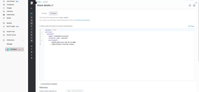

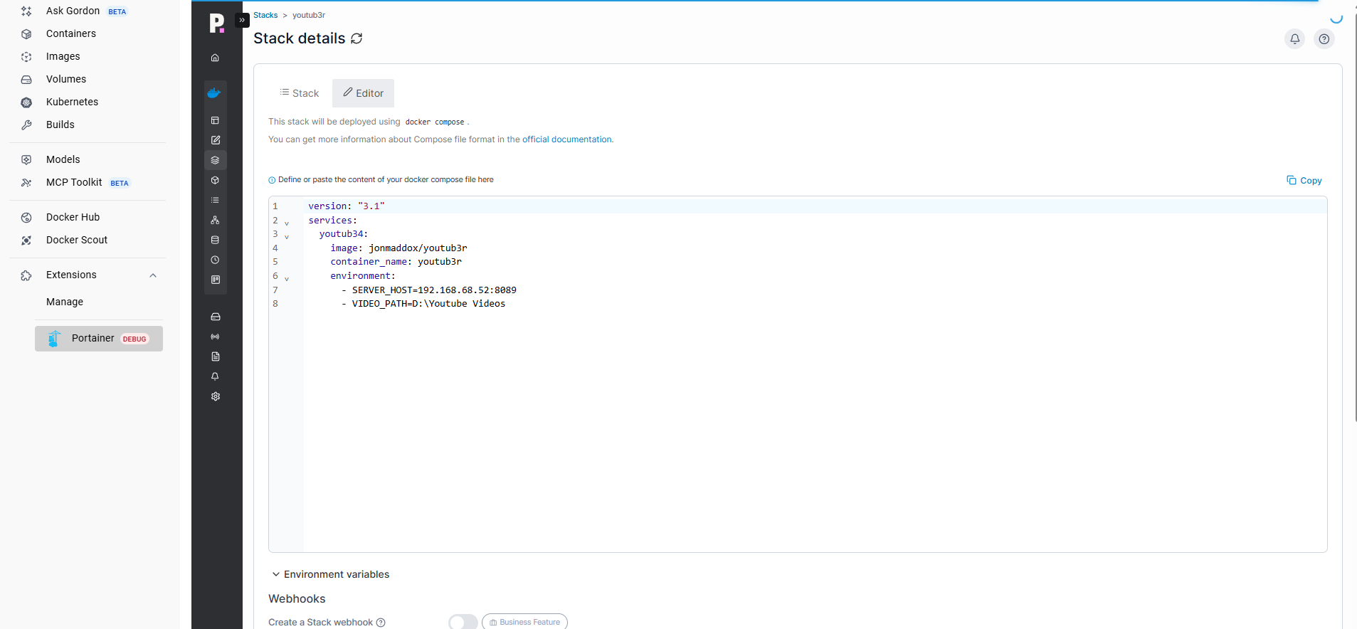

Now, I installed Youtub3R in docker (I am using Portainer extension in Docker on windows) and using the editor that is in Portainer I pasted your compose file and changed the server host path and added my folder location D:/Youtube Videos to video path line. This is the same path I put into Pinchflat and it is working there. However, it doesn't seem like anything is changing in my videos that I downloaded and have set in Channels. Just so you know, I deleted the other source I was using before and setup and new folder to use with Pinchflat and started fresh with newly downloaded videos.
I am including a screenshot of my compose file in portainer in case you see something I am missing.

You're not mounting your YouTube directory into youtub3r, so it can't see your files.
I suppose I should change this. Instead of you setting the path, I should just make you mount your directory to a specific directory.
I'll make that change soon. it will be more self explanatory.

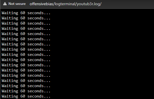

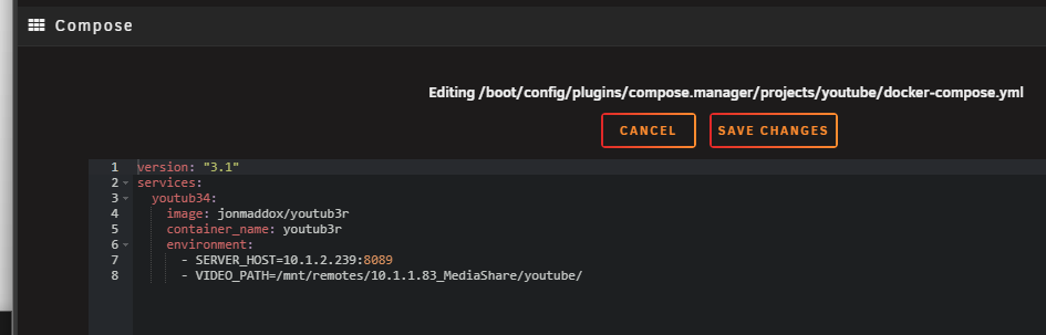

So i setup pinchflat and downloaded a full channel
And i setup your container with compose - and it continues to just say "waiting 60 seconds" and doesn't seem to find anything
Any suggestions?
oh and i'm also pulling the json
Your probably didn’t tag the Video Group correctly.

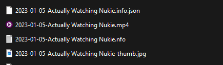

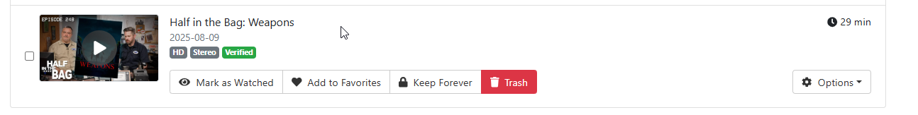

Thank you i had missed that detail - So now the files look like this

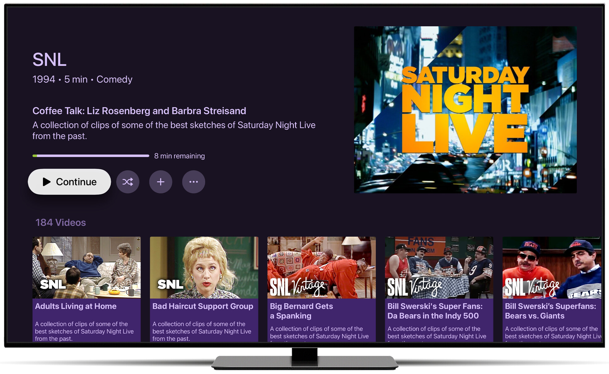

I have title and picture but i don't have description - and the show itself isn't pulling a picture like your example of snl
It doesn't pull the video's description due to YouTube video descriptions tending to be literally 2000 words of affiliate links and chapter definitions that are of no use in Channels.
As for the image, I'm not sure why it's not showing. I've never seen it not work.

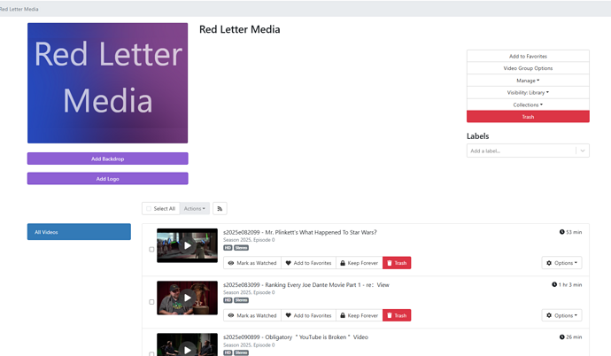

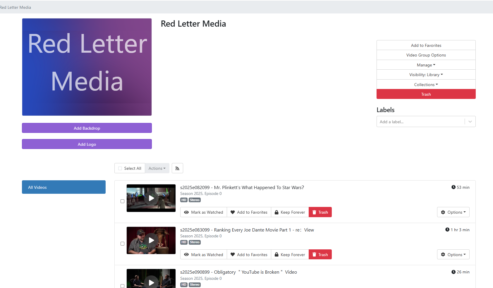

i meant that the playlist/channel doesn't have a picture - but i would assume that there wouldn't be one available - will have to set that manually - the thumbnails pull fine and I've changed my settings so those are shown
As mentioned in another message in this thread, it does not apply art to the Video Group:
