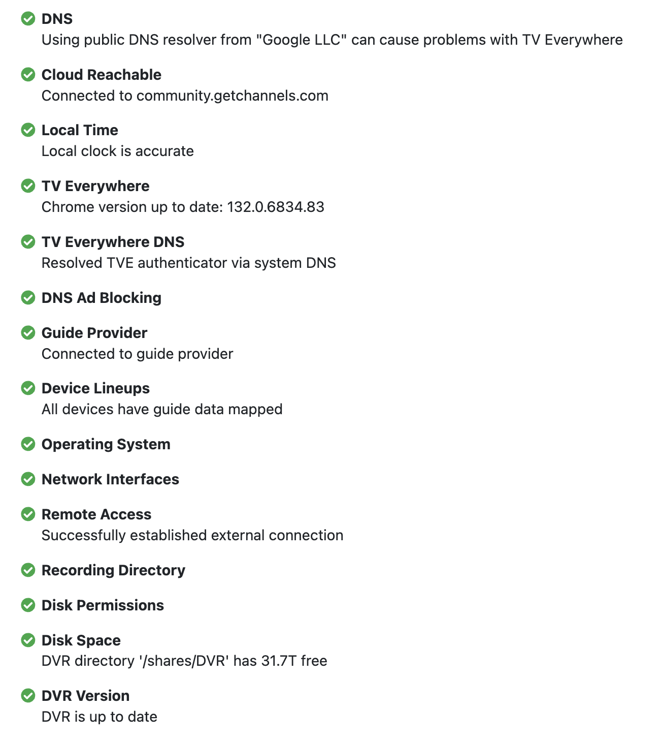

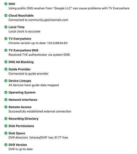

I am running it in a container now and have chrome version 132.0.6834.83, but now when i try to add YTTV I get this message: authn: POST: https://sp.auth.adobe.com/adobe-services/session: 401 Unauthorized: "Data not found"
I do, but it is not enabled for the VLAN that it lives in. Unless Google DNS is causing the issue? It has worked for years with these settings.
I know the Devs here recommend using your ISP for DNS over google. Can't hurt to try.
I agree. I was using Cloudflare DoH DNS and encountered strange issues. I'm now back to my ISP DNS.
Swapped DNS to ISP. Unfortunately, same error: authn: POST: https://sp.auth.adobe.com/adobe-services/session: 401 Unauthorized: "Data not found"
