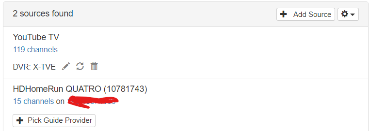

YouTube.TV has recently added 8 new channels to their lineup. I just added YouTube.TV to my Channels DVR system and it scanned 209 channels and lists 112 on my DVR page but when I go to the Channels app on my TV, it doesn't list the new channels YouTube.TV just added like CMT, MTV, Nick, Paramount Network, etc .....how can I get all the channels showing on my Channels DVR guide?

One other question ....I have an HDHomeRun that I was using for local channels but it's so spotty I don't use it anymore. On my Channels DVR it's still seeing the HDHomeRun and on my Channels app it's wanting to use the HDHomeRun for the local channels even though YouTube.TV has my local channels. How can I view the local channels using the YouTube.TV instead of the HDHomeRun? Do I just need to disconnect my HDHomeRun altogether?
On your Client set the YouTube TVE tuner to higher priority.
I already have it above the HDHomeRun as priority but it's not picking up local channels because of the HDHomeRun
On your Client ... Make sure youtube is the highest. The Clients also have tuner priorities.
I did that...but it's not picking up the local channels.
Do you have local networks via TVE checked in the web page ? under Experimental Toggle experimental features and integrations
Just checked CC. YTTV is not listed as a provider yet, so no TVE support
I didn't...but I do now. It found 1 additional channel which is local KOCO (ABC) but it's not finding NBC, CBS, FOX local stations and when I try to view ABC local it says I'm not authorized. One of the whole reasons I subscribed to the Channels DVR app is so I could watch ALL my channels through the app. If I have to go into the YouTube.TV app just to watch local channels, I might as well watch the others in the app as well ...Channels app is kind of useless to me at this point then
