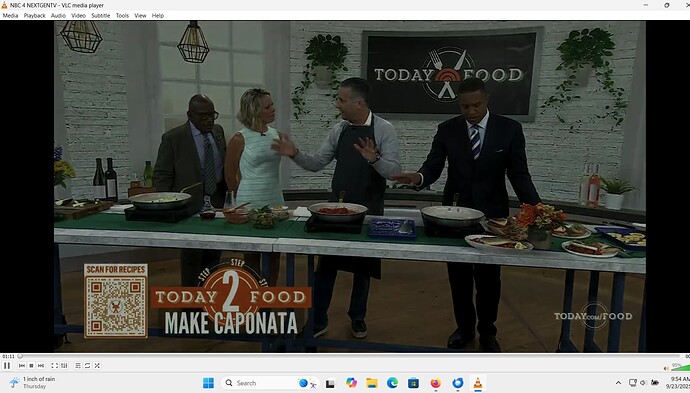

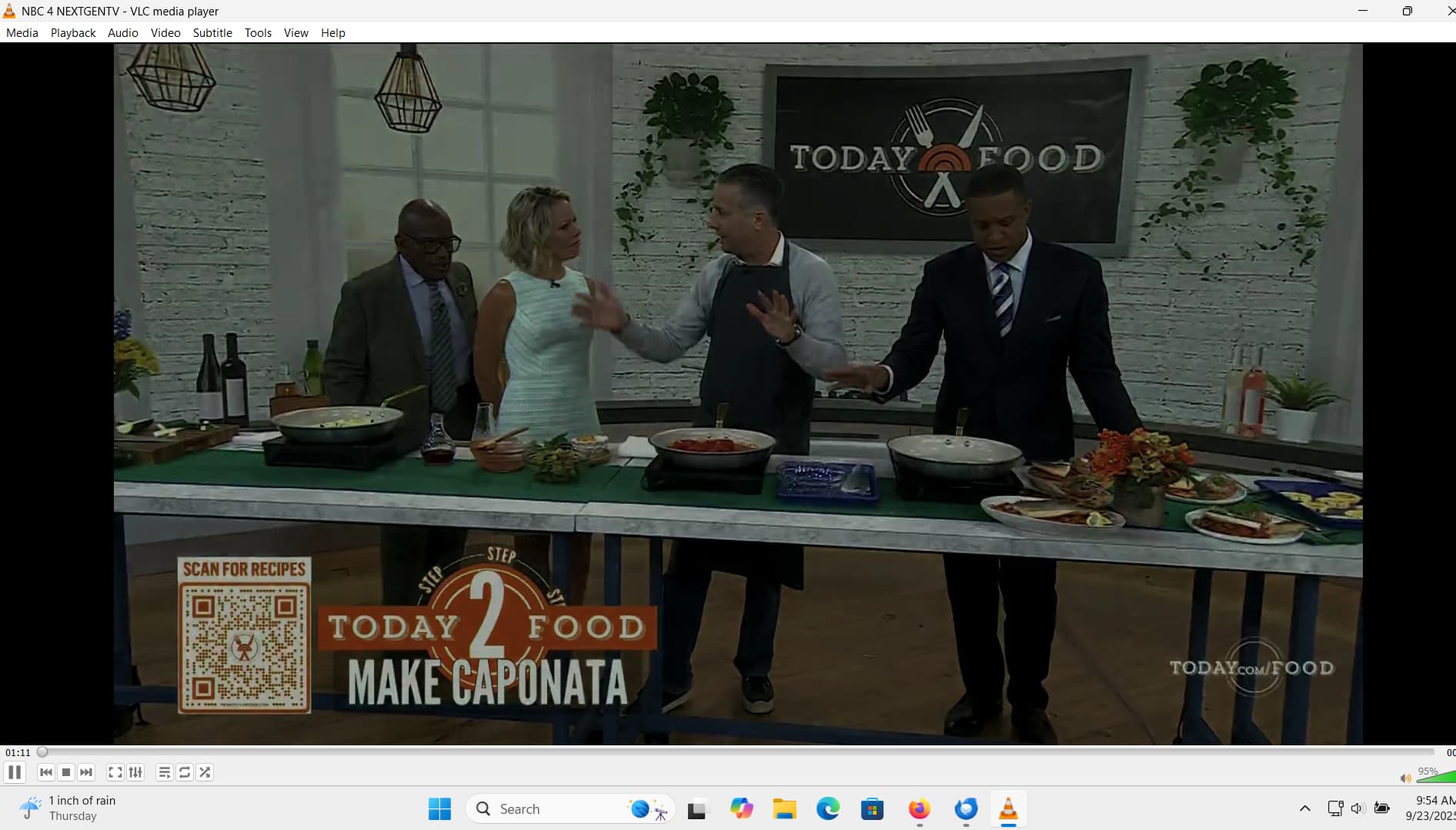

Picture quality is not as good as my hdhomeruns or adbtuner so I would appreciate it if there is somethning we can do about that.
Screenshot below from vlc

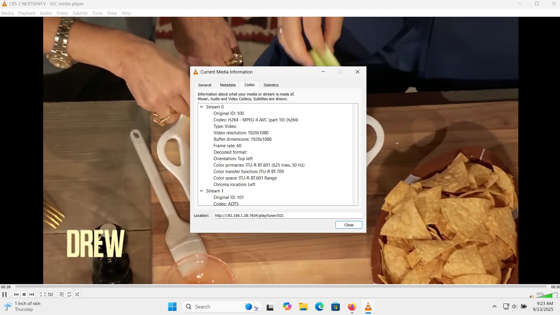

Also the bitrate is much lower in channels than what I have set on my linkpi
ah4c is just a proxy, so the stream Channels is getting is what your encoder is putting out. Check the settings on your encoder, but maybe this is the HDR issue previously discussed in the ADBTuner thread?

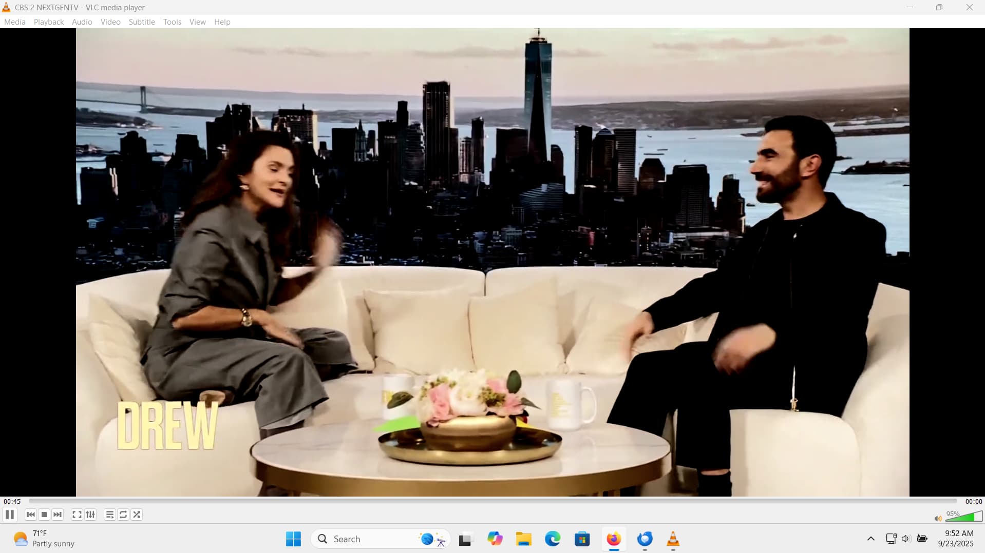

I switched my linkpi to cbr and upped the contrast. looks much better on cbs. nbc still looks dark screenshot below
That looks like HDR, at least on NBC, and probably both channels. ah4c does have the capability to pipe a stream through its included ffmpeg, but the resource requirements for the ah4c container will go from basically nothing to an unknown something (if you follow what I mean). The idea would be to tone map HDR to SDR.
