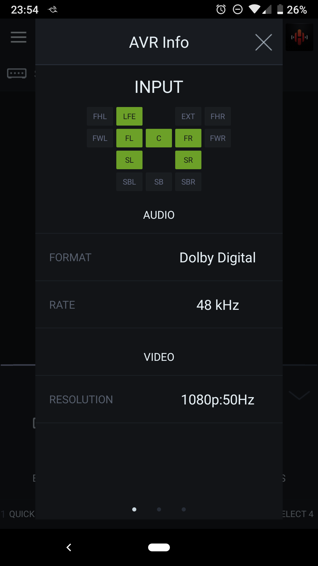

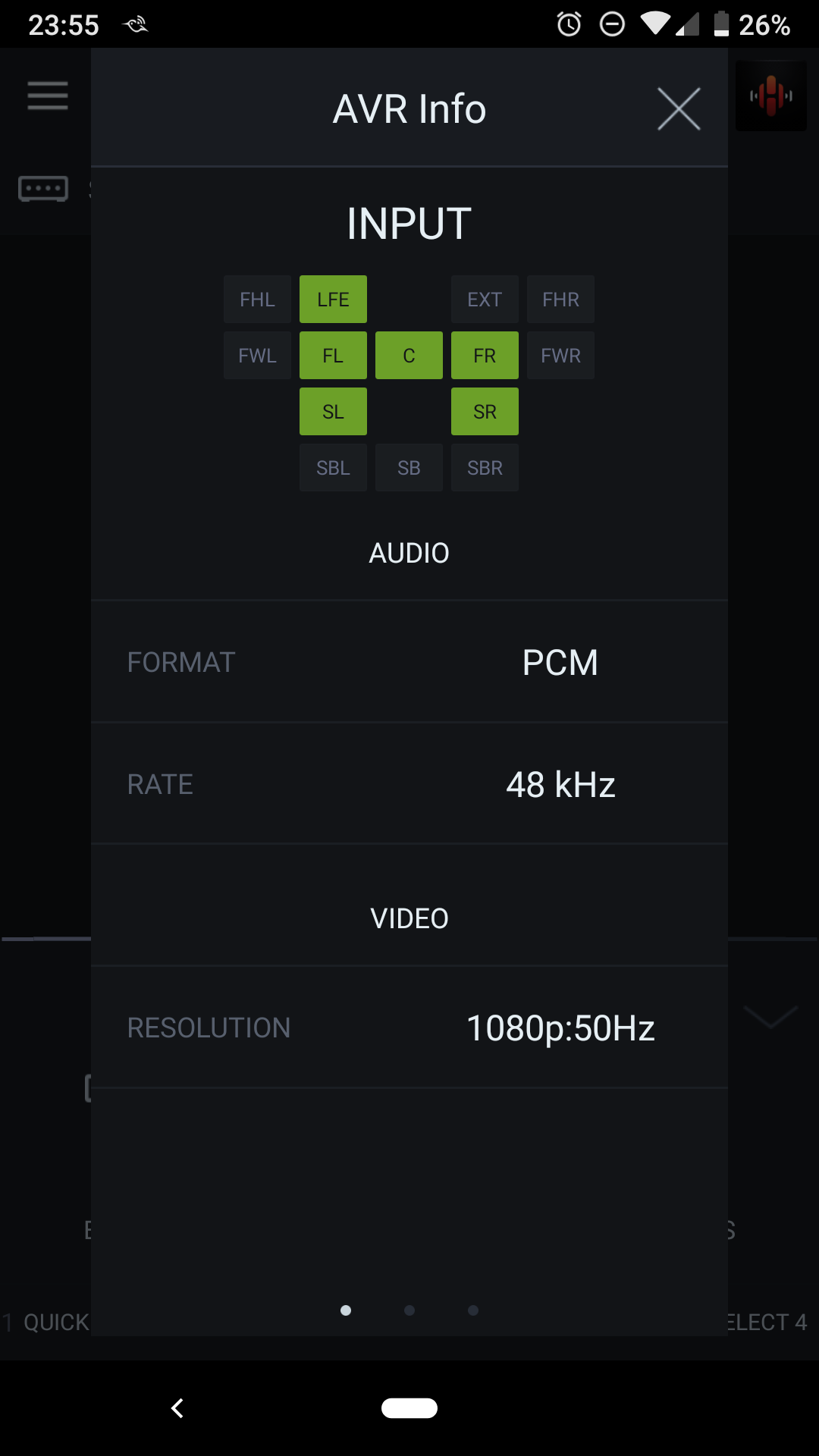

Just tried Match of the Day in HDHR app & getting DD 5.1 but in Channels getting PCM 5.1

How odd, This is what I'm getting but TBH it doesn't sound very 5.1, eg dialogue is coming out of FL & FR instead of centre. Is that normal for MOTD (I don't watch usually)
It’s normally out of the centre and crowd noise out of the rears.
Not sure my sound bar supports PCM so I guess this might be the issue.
Take it Channels doesn’t do DD by the fact your getting PCM. Although I could never get it working on Plex live TV and I’m sure that would be done in DD
