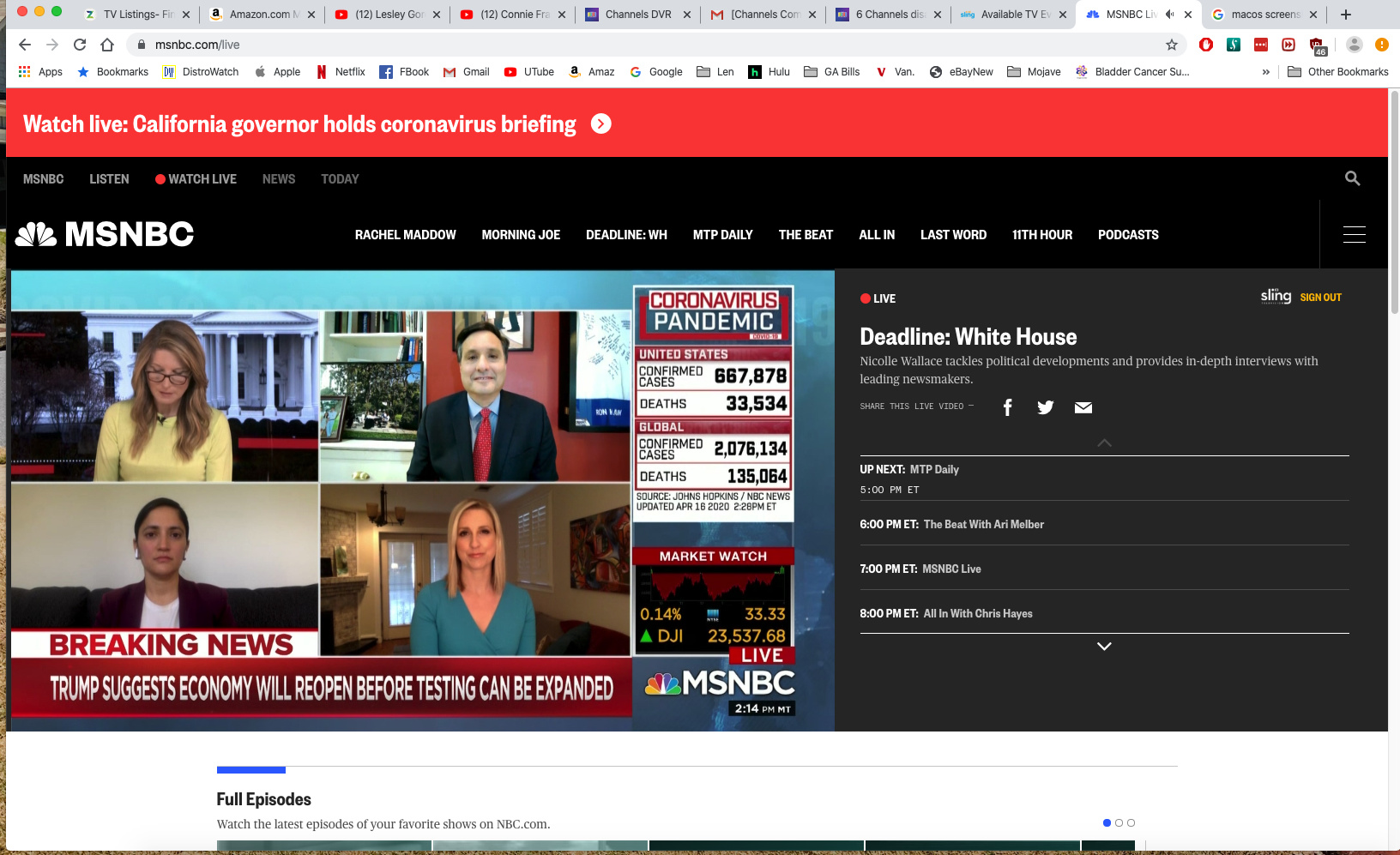

This is the link that works for me in my browser.
Here is a screenshot. Notice in the right corner I am signed in via Sling.

I can watch here with sling login: https://www.msnbc.com/live

Here is a screenshot of the web browser:

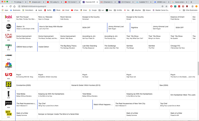

On my Android TV Channels, the guide now shows MSNBC, but the guide info is incorrect. Id does not show the accurate info as to what is on now, and nothing works when you click on it.
Reload the guide data on the settings tab of the web UI
UPDATE:
I did reload the guide data.
I can access the Live version of MSNBC within the Channels guide, but only if I click on it in the ON NOW menu. But still not working in the grid guide.This only works within the Android App. Still nothing working in the browser.
UPDATE:
The grid guide appears to be working as normal. I checked it on both my Android TV's and looks good at the moment.
