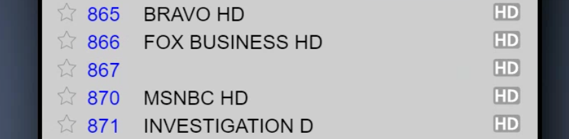

It shows up on my Prime channel scan but does not yet have a name. The channel itself is live but I am unable to find "ACCN" as an option to assign guide data.
The gracenote station ID is 111871

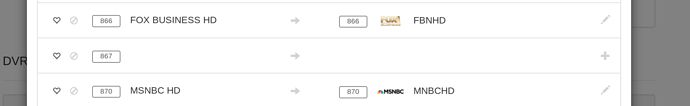

Once they start transmitting the callsign I assume SD will map guide data and you can pick it up by hitting circle refresh icon under your HDHR.
In the mean time you could use the custom mapping command with the above ID.
curl -XPUT --data '{"867":"111871"}' http://127.0.0.1:8089/dvr/guide/stations/USA-SC39506-X

Click the circle refresh icon under your HDHR
I tried that multiple times. That did not work. The ACCN channel does not appear in any channel list.
Does it show up on my.hdhomerun.com under Channel Lineup?
Initially not. But then I re-ran the Channel Detection and they now show up under my.hdhomerun.com as channels 329 and 829. However, after again updating HDHomeRun PRIME ( the circle refresh icon ), those channels still do not appear in my ChannelsDVR channel lineup (the pencil icon).
BTW, I notice that even after clicking on the version "check for update" button, it shows the latest version as 2019.08.15.2304, not the later version number you had posted earlier in this thread.
In the DVR web UI, click the gear icon in the HDHR area and then click Scan Network. After that click the circle icon under your HDHR.
